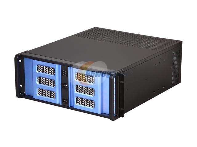

Well, I ordered the parts today. Here's the list:
Mobo: Supermicro X9SCL-F $149
CPU: Pentium G2030 dual core 2.8GHz for the 1155 socket $61
RAM: 2x Crucial 4GB DDR3 1600 Not tested by Supermicro, but recommended by Crucial as fully compatible with my mobo. $44.98 each
Case: iStarUSA 400SE (see photo) that comes with a 500W 80Plus power supply $280
HDD: I'm starting out with a single WD Red 2TB HDD $93.98
I put the prices in to see if I paid too much for anything. I think I'll be able to build a very nice albeit small NAS for under $1K. With this mobo, I can add 5 more HDD before I have to add another controller.
Question about IPMI. Can I connect a LAN cable from the main computer's unused RJ45 port to the IPMI port on the NAS and have a hard-line secured connection? Both my computer and the NAS will have static IP addresses.
