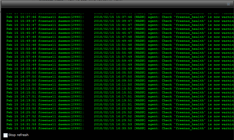

FreeNAS-11.1-U1, The status light is
search
GREEN , but I see this in the console area
Jan 27 23:40:31 Nas daemon[3105]: 2018/01/27 23:40:31 [WARN] agent: Check 'freenas_health' is now warning
Jan 27 23:42:32 Nas daemon[3105]: 2018/01/27 23:42:32 [WARN] agent: Check 'freenas_health' is now warning
Jan 27 23:44:32 Nas daemon[3105]: 2018/01/27 23:44:32 [WARN] agent: Check 'freenas_health' is now warning
Jan 27 23:46:32 Nas daemon[3105]: 2018/01/27 23:46:32 [WARN] agent: Check 'freenas_health' is now warning
Jan 27 23:48:33 Nas daemon[3105]: 2018/01/27 23:48:33 [WARN] agent: Check 'freenas_health' is now warning
What is Warning about? How do I fix it?

It's a bug in 11.1-U1, it will be fixed in next update. See this thread for more info.

As mentioned above, it's a bug that will be fixed in the next update.

Did you look at the thread reference @Redcoat gave you?
There is a fix to stop the log spam.
Read up that thread, maybe a dozen posts.

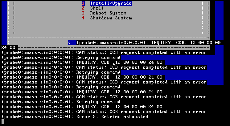

Thanks,but I am thinking to go back to Freenas 9.3, cause this 11.1 has to to many bug probably to dealt with.It's my first install of Freenas 11.1 and already 2 issues just from install to finish:
From the beginning of installation starting with the first pic and after the install is complete you got the that.
Nov 11, 2014
1,174
I forgot to upload after the install pic. Here it is:
You literally just paste these four lines in at the command prompt and it stops the log spam. Done. What other problem are you talking about?
cd /usr/local/etc/consul-checks/
rm freenas*
wget https://raw.githubusercontent.com/freenas/freenas/8175ddd35c189c43c47a51e42a1353e96d9ac2cb/src/freenas/usr/local/etc/consul-checks/freenas_health.sh
chmod a+x freenas_health.sh

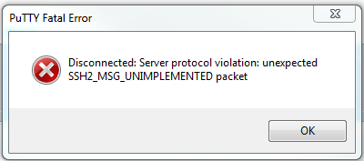

I appreciate you help, Honestly. The other issue was the other screenshot. I just posted 2 cause these I got just from install to finish , I haven't mess with it longer to find out what else is not right. No offense to anybody.
P.S. Since you ask, I just notice I can't connect to SSH with putty as before. I did enable SSH and allow "Login as Root with password:" same as before. Here is screenshot.
