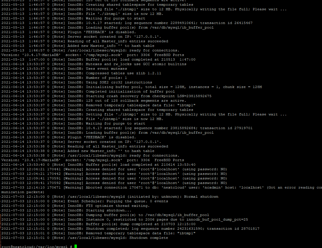

Krautmaster
Apr 10, 2017
81
i'm having the same issue. I ran pkgupdate and now it seems mysql not to start at all
root@nextcloud:/tmp #
root@nextcloud:/tmp # cat /etc/rc.conf
cron_flags="$cron_flags -J 15"
# Disable Sendmail by default
sendmail_enable="NO"
sendmail_submit_enable="NO"
sendmail_outbound_enable="NO"
sendmail_msp_queue_enable="NO"
# Run secure syslog
syslogd_flags="-c -ss"
# Enable IPv6
ipv6_activate_all_interfaces="YES"
apache24_enable="yes"
mysql_enable="yes"
redis_enable="yes"
php_fpm_enable="yes"
root@nextcloud:/tmp # sh -x /usr/local/etc/rc.d/mysql-server start
