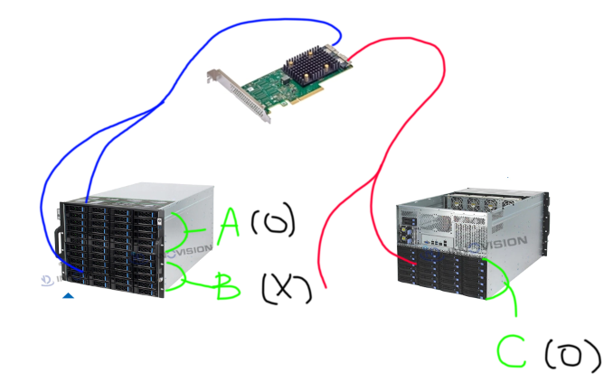

My HBA card can connect 1024 SAS devices.
and My NAS chassis has three backplanes and each backplane has an expander chip and 24 bays.
so I put one HBA card on my server and connect three backplanes to the HBA card.
However, TrueNAS only recognize SAS devices that are mounted on two backplanes.

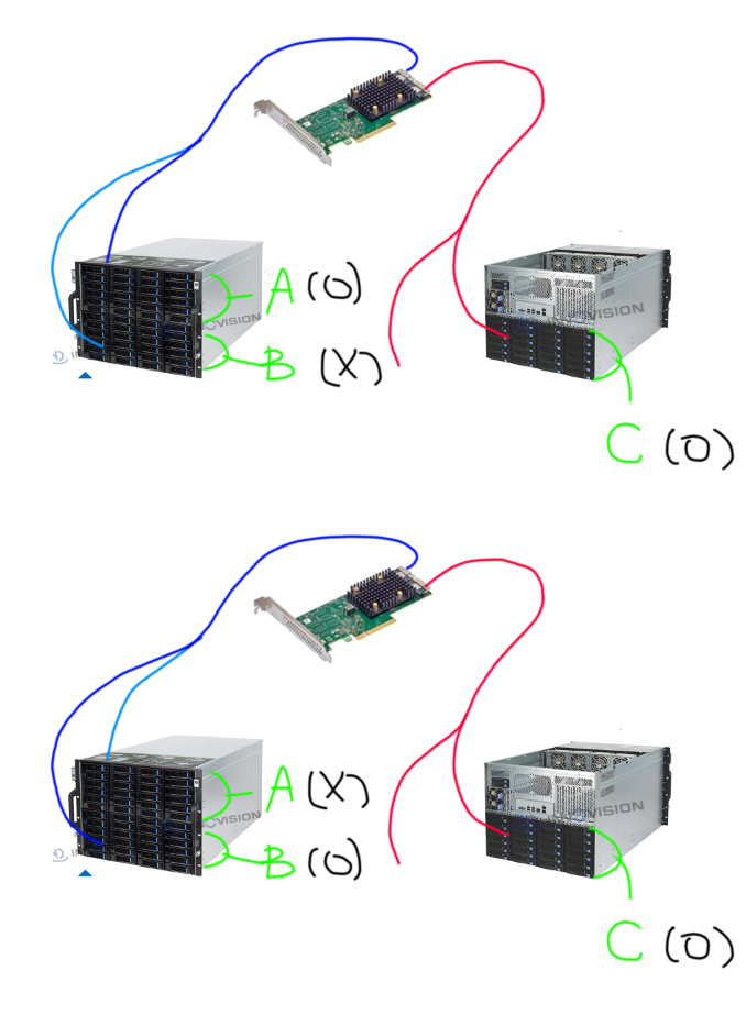

for example, there are A, B, and C backplanes. each backplane has SAS devices such as A-1, A-2, B-1, B-2, C-1, C-2
TrueNAS recognize A-1, A-2, C-1, C-2 but not B-1, B-2.
If I switch cable A and B then, TrueNAS recognize B-1, B-2, C-1, C-2 but not A-1, A-2.
HBA card only recognize up to two expander chip?
Do I need one more HBA card?
Please let me have your valuable advice.

I connected two SFF-8654 to SFF-8643 Cables.
so backplane side, there are a total of four SFF-8643 connectors.
one SFF-8654 to two SFF-8643, (backplane A and B)
one SFF-8654 to one SFF-8643 (backplane C), the other SFF-8643 is not connected anywhere.

Hi, Yes. I did change cable to new one. but same.
and If I switch blue cable backplane side, backplane A is disabled instead.
I assume HBA card each port recognize single expander chip.

Question - what happens if you switch the red and blue cables at the HBA itself (so that port0 on the HBA is going to A+B, and port1 is going to C+null)?
I wonder if perhaps there's some oddity that made it detect only an x4 wide port on the first cable, and make some (incorrect) choice to just use an x4 on the second cable in the thought that it's going to a dual-path backplane.
Checking the SAS topology/tree in the BIOS/UEFI may provide some insight as @Ericloewe mentioned. Also, which of the ports on the backplane are you using? Look for any labels or printing that will indicate which of the two ports close together is the primary/first port, and connect there. The "single port" at the lower section of each backplane is likely intended to connect an additional/downstream device.
In a worst-case scenario, you can likely chain the two front planes together.
