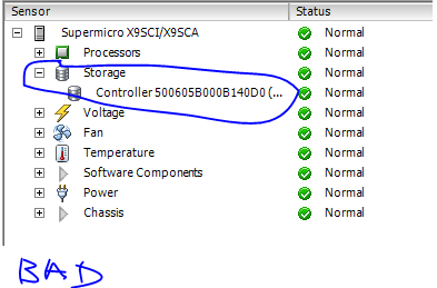

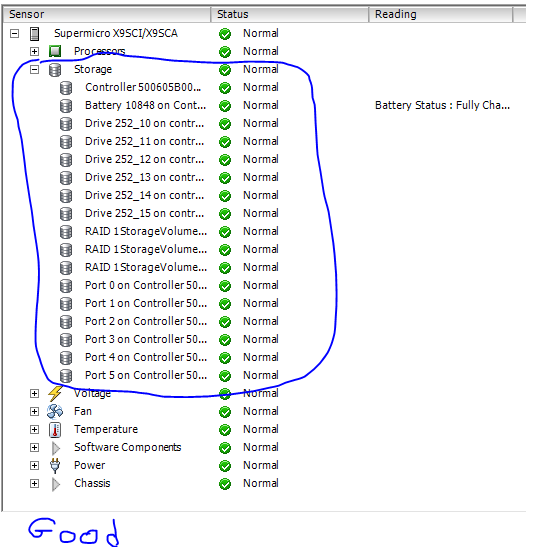

Hardware used:
ESXI 5.5 U3b
X9SCI-LN4F/E3-1230v2/32GB RAM
LSI 9271-8i
I did install everything like suggested in this thread.
All worked fine for a while (see pic) , then it disappear(see pic). If I reboot ESXI it will come back, and stay there for around a month then go away again ?!
What Am I doing wrong ? Does this happens to anybody else ?
P.S. Sometime even the whole "storage" section is gone.

Question: While the drives are indicated as not present, are they actually not present, meaning is your data available or is the fact your data is not available and this is why you are asking the question?

Fortunately , this doesn't affect the raid card operation. No drives or controllers are actually disappearing from esxi, just the health info is gone and also I can no longer monitor raid card status from Windows VM running LSI Management software. But I can ssh in to esxi and run storcli command and I can see raid card status from there.
I am assuming this has something to do with lsiprovider driver. Cause he is the one who bring this functionality in a first place.
Very possible and actually likely.

Yeah I think so too. But I wish somebody enlighten me what the problem is. I read here and there about some CIM server that perhaps should be running, but I never had this thing running in a first place and it was working after reboot. I don't know enough about this service and it's relation to the problem to know how to fix it.
P.S. It's not that I am lazy about researching and solving problems, but sometimes it takes too much time to figure, thinker ,read and test to get something to work(that should work in a first place) that you don't have a time to actually use it. In this ESXI 5.5 hyper-visor, with this hardware , with this (lsi 9271) raid card I got almost everything to work perfectly , after more than a year of messing with it I just want to get to the last piece of the puzzle, fixed and enjoy just using and maintaining it.
I could try esxi 6.0 (since stil have the C+ software vshere), I could buy a lsi 9361 (like jgreco mention a year ago) it's not even more expansive than 9271 , but I don't want to jump in a whole new ocean of new issues that I have to spend a year ot two to deal with it. I rather have a older hardware and software , that is rock solid and I won't have constantly go back to fix issues so I can move forward with new things.
