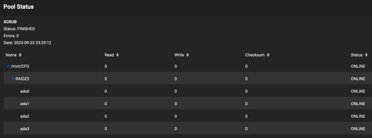

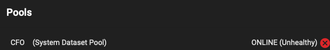

My pool CFO is reported as unhealthy:
When I go in the status, it shows me this:
I recently ran a scrub which came back with zero error.
Also running the status command gives me the following output:

  scan: scrub repaired 0B in 11:13:45 with 0 errors on Sun Sep 24 07:42:57 2023
config:
    CFO                                             ONLINE       0     0     0
      raidz2-0                                      ONLINE       0     0     0
        gptid/XXXX-cbf2-11ec-b2fb-XXXX  ONLINE       0     0     0
        CFO/FreePBX-tw80i8:<0x1>
I don't understand what it means.
How is my pool unhealthy and how can I fix it?
