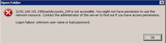

sukarechhe
Nov 16, 2021
35
It works fine with permission we set on folder. Just a question. if my pc isn't in a domain then it doesn't ask for credentials to connect linked folder.. can we set any option here ?
