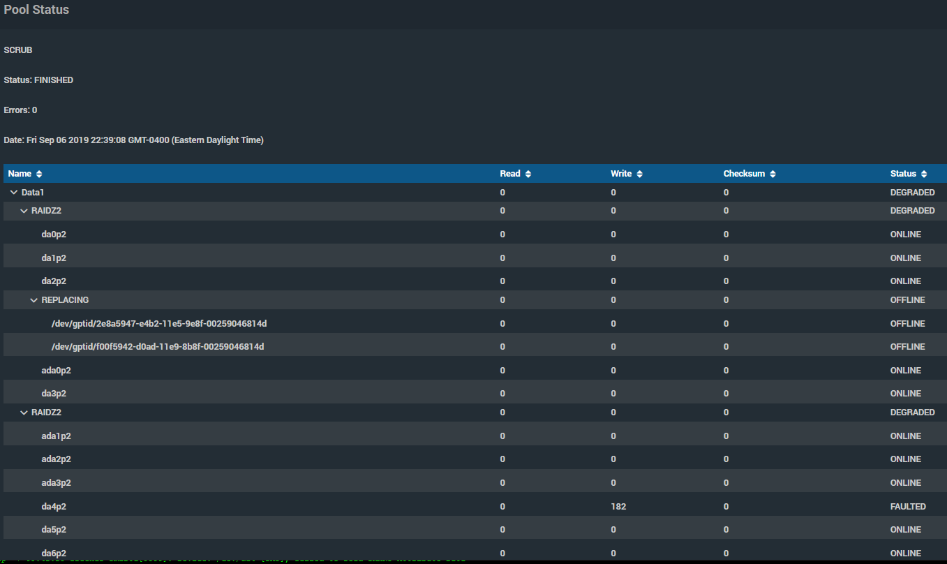

I am looking for recommendations on dealing with the following. I'm pretty sure this is an intermittent issue with my Serveraid M1015 (46M0831) controller since I just replaced both 4-way cables from the M1015 and I doubt 3 HDs are failing at the same time. In the past I was getting Read and Write errors and reseating the cables and rebooting cleared them.
This time I had a disk in the first Vdev log a number of errors and on replacing it the replacement drive started reporting errors and went offline. While all this was going on, da4 in the second Vdev faulted.
Wasn't sure if I should just reboot and see what happens. Or shutdown, unplug new drive in the first Vdev that I was replacing, and then power up.
The 182 Write errors on da4 should clear on a reboot either way.

My Data1 pool is now being reported as HEALTHY and none of my drives are reporting any read, write, or checksum errors.
To get here I performed the following steps:
1) Replaced the OFFLINE drive with a new disk in my first Vdev
2) Resilvered my Pool
3) Rebooted which cleared the Write errors on da4
4) After rebooting da4 showed 14 checksum errors so I ran 'zpool clear Data1 gptid/206a16af-b56e-11e9-9264-00259046814d'
I've started long SMART test on dirves da4 and da5 and will see what that reports. Drive da4 is an old HGST 4TB unit and da5 is a brand new Toshiba 6TB N300. Due to the nature of the failures on drive da5 (see below) I was told these look more like disk controller or cable problems than actual hard disk failures. Since I've already changed the cables on my M1015 maybe I should order another Serveraid M1015.

  04 31 00 12 78 8e 09
  Commands leading to the command that caused the error were:
  CR FR SC SN CL CH DH DC   Powered_Up_Time  Command/Feature_Name
  ea 00 00 00 00 00 00 00      12:07:34.944  FLUSH CACHE EXT
  61 10 00 f8 d2 4b 40 00      12:07:34.943  WRITE FPDMA QUEUED
  61 08 48 a8 18 eb 40 00      12:07:20.964  WRITE FPDMA QUEUED
  61 08 40 68 e8 4b 40 00      12:07:20.964  WRITE FPDMA QUEUED
  61 08 08 98 c5 4e 40 00      12:07:20.964  WRITE FPDMA QUEUED
Error 1 occurred at disk power-on lifetime: 5 hours (0 days + 5 hours)
  When the command that caused the error occurred, the device was active or idle.
  After command completion occurred, registers were:
  ER ST SC SN CL CH DH
  04 31 00 36 ef 7a 0d
  ec 00 00 00 00 00 00 00      03:08:59.776  IDENTIFY DEVICE
  aa aa aa aa aa aa aa ff      03:08:56.746  [RESERVED]
  ea 00 00 00 00 00 00 00      03:07:25.472  FLUSH CACHE EXT
  61 08 00 98 0f f4 40 00      03:07:25.470  WRITE FPDMA QUEUED
  61 08 00 d8 21 40 40 00      03:07:25.470  WRITE FPDMA QUEUED
# 1  Extended offline    Completed without error       00%       785         -
# 2  Extended offline    Interrupted (host reset)      90%       771         -
# 3  Short offline       Completed without error       00%       725         -
# 4  Short offline       Completed without error       00%       491         -
# 5  Short offline       Completed without error       00%       392         -
# 6  Short offline       Completed without error       00%       296         -
# 7  Short offline       Completed without error       00%       224         -
# 8  Short offline       Completed without error       00%       128         -
# 9  Short offline       Completed without error       00%        56         -
#10  Short offline       Completed without error       00%        26         -
#11  Extended offline    Interrupted (host reset)      90%         5         -
#12  Short offline       Completed without error       00%         4         -
I found the following sites useful in decoding these SMART tests.
https://en.wikipedia.org/wiki/S.M.A.R.T.#Known_ATA_S.M.A.R.T._attributes
https://www.backblaze.com/blog/what-smart-stats-indicate-hard-drive-failures/
Oct 18, 2018
969
The da5 6TB Toshiba N300 still in my FreeNAS box is reporting SMART 5: 65320, SMART 196: 7738.
Yes, you're right this typically indicates an issue with your drive, especially with that many reallocated sectors. You could be having unfortunate issues with the drive AND the card. If I were you I'd figure any drive reporting SMART values like that are likely bad. If you're also seeing errors related to issues communicating with the drives you may consider replacing cables or your HBA. Often a non-zero RAW_VALUE in 199 UDMA_CRC_Error_Count will indicate an issue communicating with the drive.
I pulled the da4 4TB HGST drive out of the FreeNAS box and put it in a Synology NAS, ran a long SMART test and it reported back SMART 5 (Reallocated Sectors Count) of 77 and SMART 197 (Reallocated Event Count) of 87.
Were you unable to run the SMART tests from your FreeNAS machine?
TAC
Feb 16, 2014
152
Since this drive was listed as FAILED or OFFLINE and didn't show up in of the reports (and I had a spare 4TB drive) I just swapped it out.
