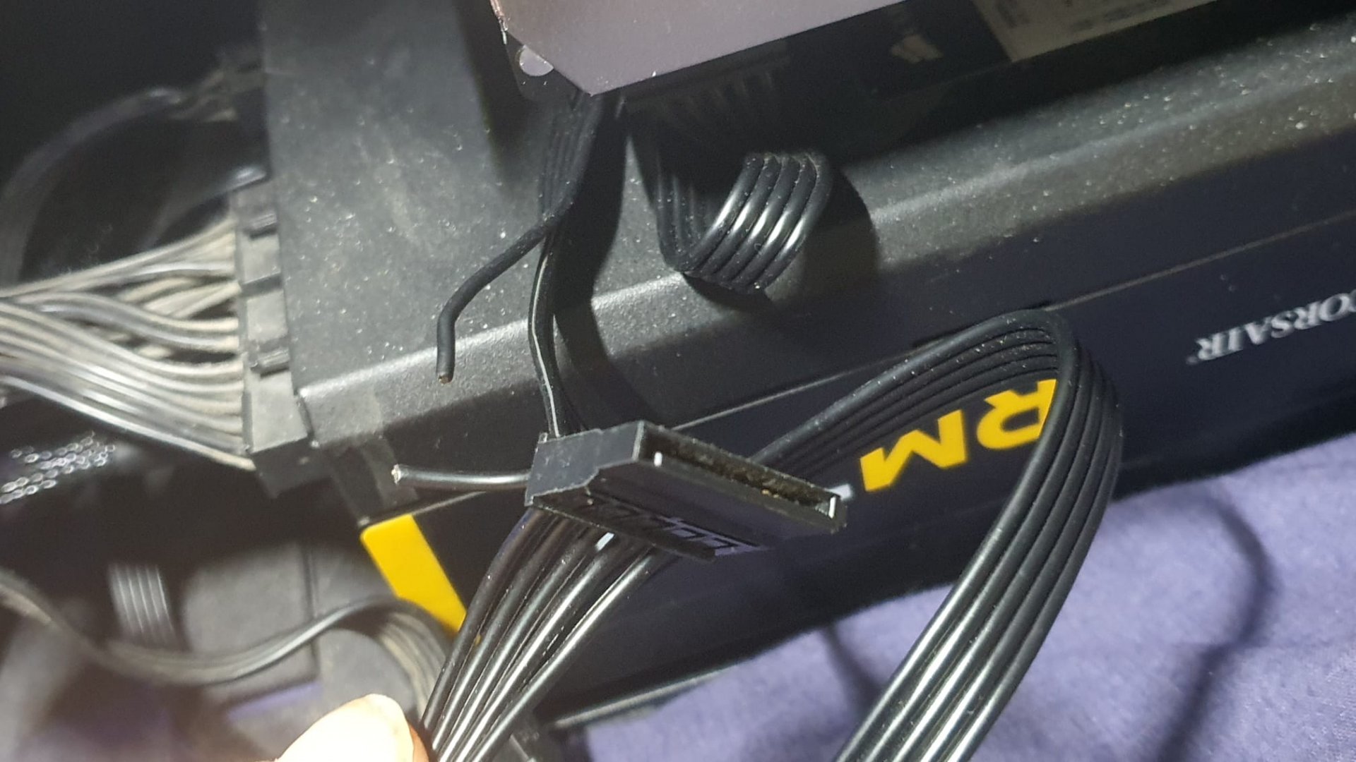

FIXED my issue. It seems, power to the HDD's was being cut. The SATA raid card wasn't detecting the HDD, as a result, The Raid card was ignored by the mobo. My hdd's are from external WD enclousures "White Label" and it seems the 3.3 volt rail need to be disconnected. Most tape the pin but as corsair use wires i just cut the 3.3volt wire.
This is Now, allowing the hdd to be seen by TrueNAS and allows me to set up a raid config. I hope this helps others, forgetting the 3.3volt rail hack in WD "White Label" HDD's.

Typical issue with HGST drives, and thus also WD-rebranded HGST designs. Good job!
Many of these are available with and without PWDIS. Always check the datasheet and decode the part number!

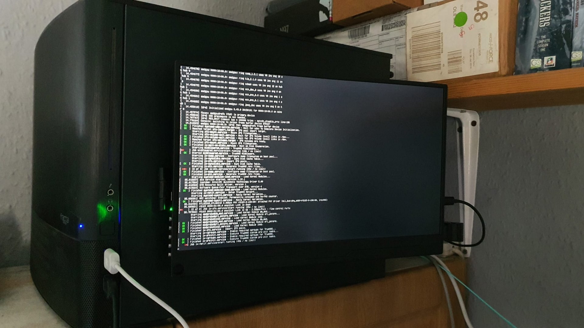

Thought id add an update. Now running 5 pools, 2 drives in each mirror. I added a cheepo 13" screen on a hinge to use as and when i do matainiance. Also added a 10gb brocade card to eventually move over to fibre and added a 10gb switch. Still learning and hope this will out last me or last for a long while.
