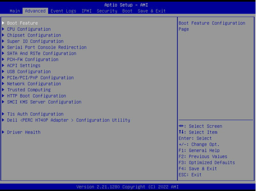

Are you sure this isn't just a UEFI thing? Legacy BIOS didn't have an option to "extend" system setup menus from PCI expansion ROMs, but UEFI does. E.g. LSI SAS2/3 cards still take the legacy extension ROM and the UEFI extension ROM. The legacy extension ROM is, I guess, an independent real mode application like the firmware setup utility itself is. But the UEFI extension ROM adds its own menus to those present in the system setup utility (no doubt describing the menu structure and callback addresses in some byzantine UEFI way), and they end up looking a lot like standard menus from the system ROM.
If the configuration menus you're referring to are similar to this (shown here for a Dell HBA330 Mini, but the structure is identical to what I have at home with a Supermicro motherboard and an HBA with a SAS2008 - with AMI's look and feel instead of Dell's), then I suspect you've simply encountered UEFI option ROMs:
Entrypoint from the setup application into the device settings (notice the tip at the bottom, the HBA and NICs have expansion ROMs and the SSDs are probably being handled by a driver included in the system firmware):
Well, here I am doing a terrible necropost. You may recall that I had tried the H740p in X9 based systems but had no joy. Shortly after I wrote the messages in this thread, I nevertheless ordered a Supermicro SYS-510T-WTR with E-2388G CPU and 128GB RAM. Ordering it as a BTO via Supermicro allowed me to get parts that were otherwise unobtainium at the time. Some people might remember I was hospitalized for about two months soon after that, and then a month after I got home, the server showed up. But I was really not in any shape to be doing shopwork on servers. So it sat.

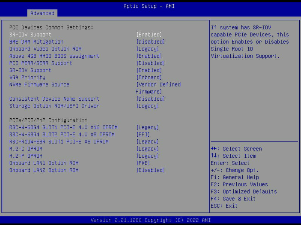

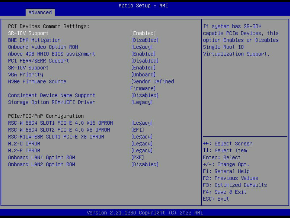

I can now report that @Ericloewe is correct, there's an EFI configuration ROM of some sort in there that integrates into the X12's AMI/Aptio setup utility. However, you have to go into PCIe/PCI/PnP Configuration and toggle the option ROM for the installed slot from Legacy to EFI. Then it seems to work charmingly well, showing up in the Advanced menu as PERC H740P Configuration. My next steps will need to be to find a tap point where I can get power for a pair of 2.5" SATA SSD's, and then hook it all up.

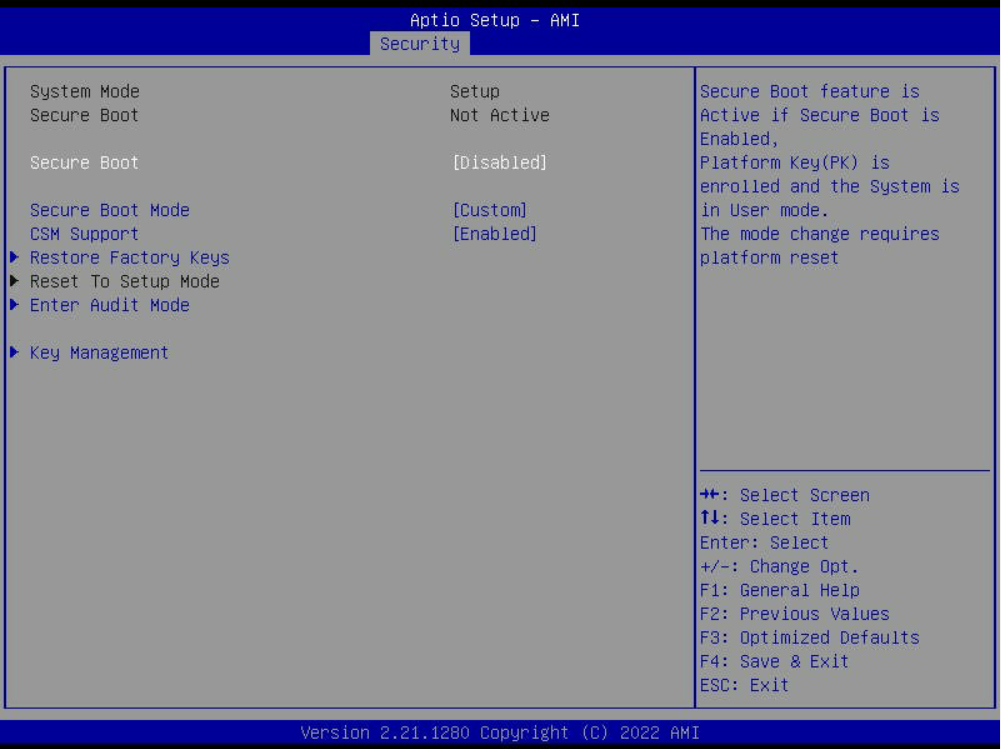

Wait, X12 still has Legacy as an option? I thought they'd gotten rid of CSM after Skylake.

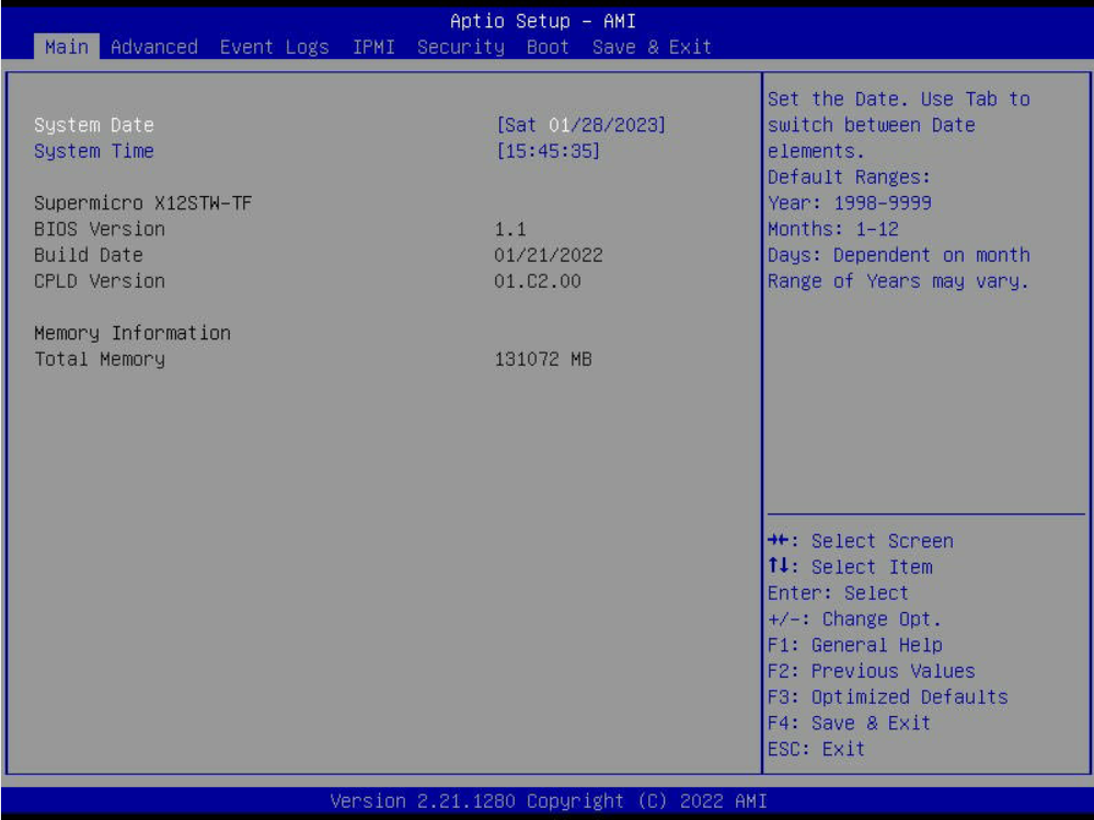

Can't comment on X11; don't have any, at least not that I can recall. This is for an X12STW-TF:
You can see the PERC show up in the Advanced menu
But only after setting the PCIe slot that the PERC is in to EFI
And there's the pesky CSM option

X11 still has CSM, both on Skylake and Skylake-SP, but there was some talk about Intel removing it from their firmware package after that.
