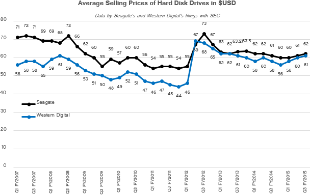

Prior to the flooding of 2011 when drive supply was interrupted and prices skyrocketed, their downward price trend has never restarted and they continue to be annoyingly expensive as only 2-3 manufacturers have all the market...
Surely you're not implying that the hard drive cartel caused the flooding in 2011 in order to introduce an artificial price floor on the global hard drive supply. :smile:

Surely you're not implying that the hard drive cartel caused the flooding in 2011 in order to introduce an artificial price floor on the global hard drive supply. :)
No, that's a typical supervillain plot. Doesn't work because it's too obvious and the people in charge can't help but brag (who wouldn't? It's a pretty big achievement).
No, they just took advantage of the floods to say "Oh yeah, we're totally supply-constricted and stuff, we'll have to jack up prices", even though nobody was actually supply-constricted for more than a few months.
