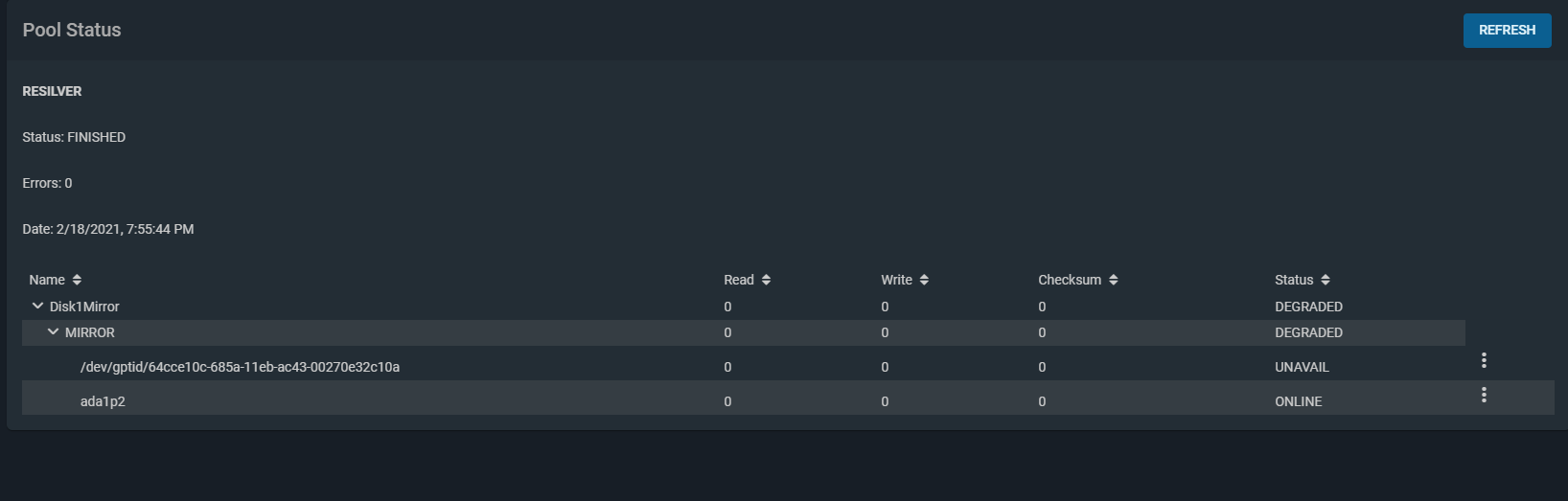

4. insert the disk back into caddy, power on the caddy or server, if you try to online the disk it will be in unavailable status, but still in the mirror, which is a good sign:-refer unavailable_but_still_in_mirror.PNG

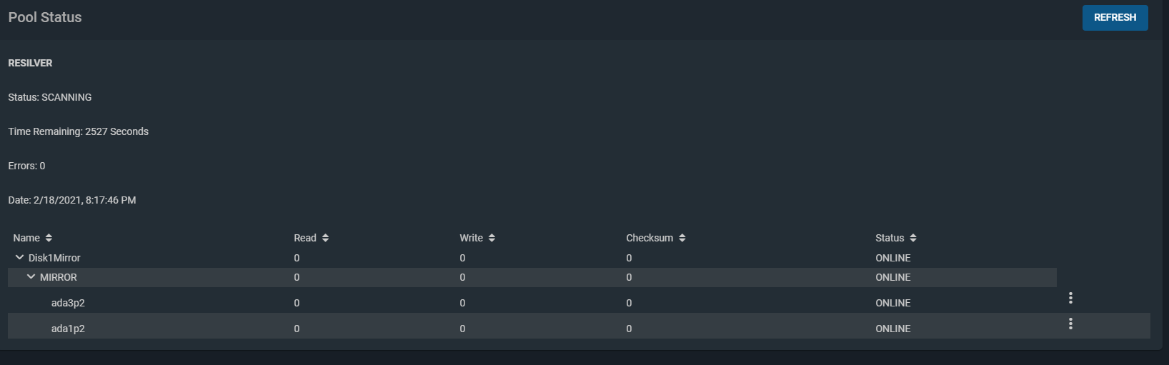

5. the hdd you have inserted should be in offline mode status in the pool, click on the drive and select replace, and choose the other drive in the mirror.:-

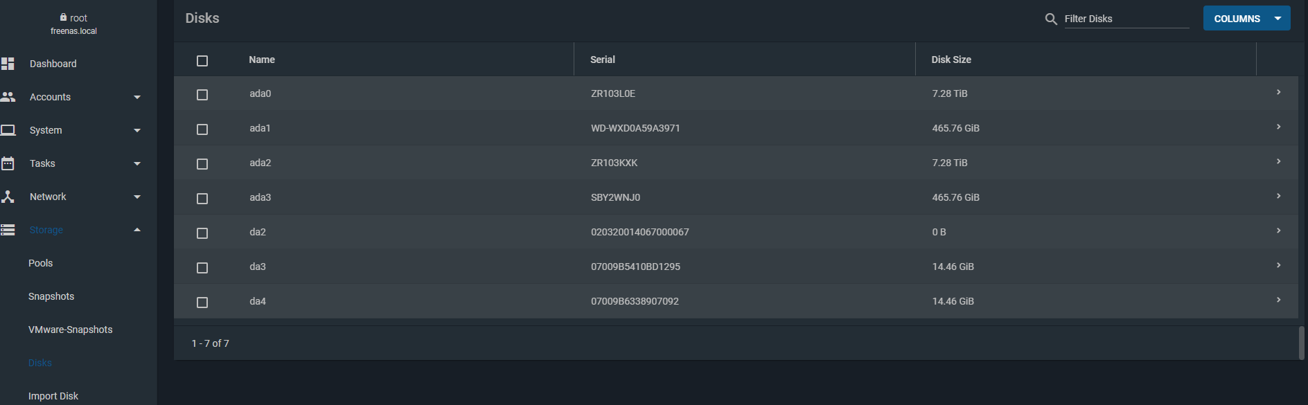

1. offline one of the hdd's ( you can findout which drive, by the serial label on the front of the physical drive and compare it to the serial label under the 'storage--->disks' section in freenas server gui) refer storage_disks.png

4. once hdd is wiped insert the hdd on freenas server, power on the caddy or freenas server, once up, if you online the hdd it will go into 'unavailable' status, but still in the mirror, which is a good sign:-refer unavailable_but_still_in_mirror.PNG
5. switch the hdd back to offline if not already done so, now click on hdd again and select replace, and choose the other drive in the mirror.:-
resilvering will commence on the replacement hdd, once this starts the hdd will automatically go online
once resilvering completes, you can then test file access on each drive by enabling offline. note it will only let you offline 1 drive if you have 2
in a pool mirror. If you have more than 2, one will always be online.
