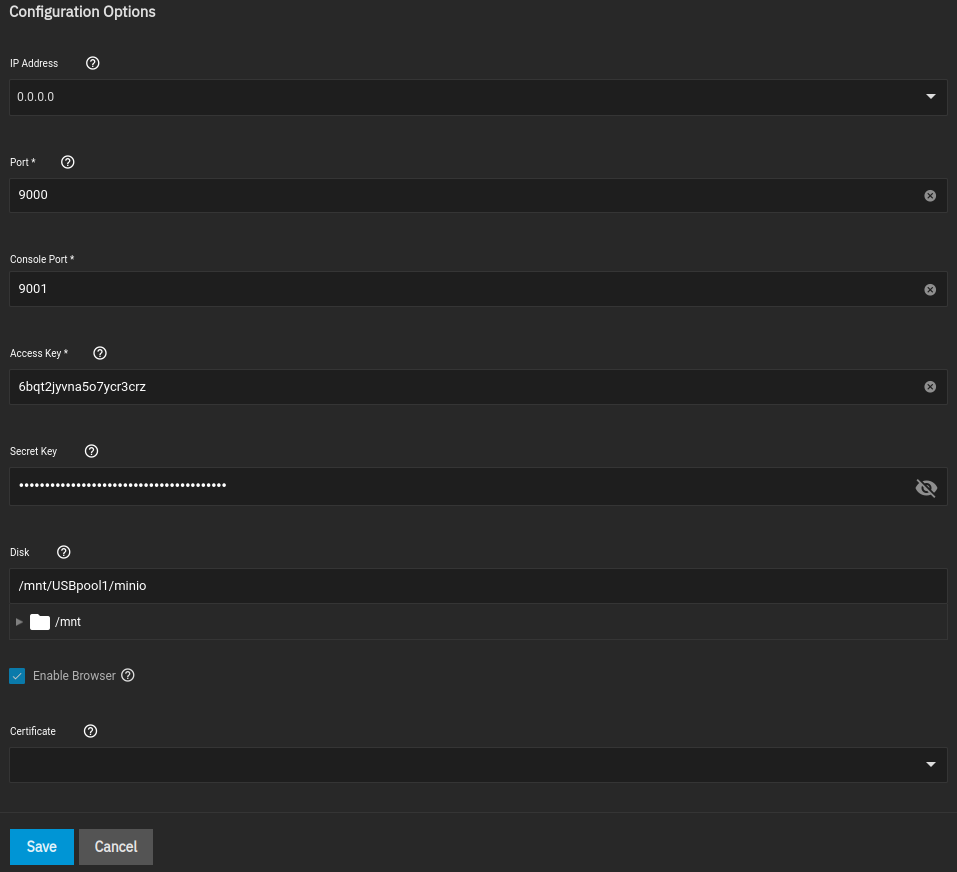

In the S3 configuration panel in System Settings, I couldn't for the life of me see why the Save button was disabled. Not a peep as to why. Then I saw someone, in one of those howto articles mentioned as an aside that the key values could be only alphanumeric. Again, not a peep in the TrueNAS documentation or settings panel. :mad: Anyway, here is my S3 configuration panel:

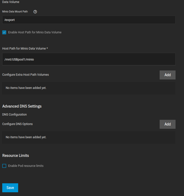

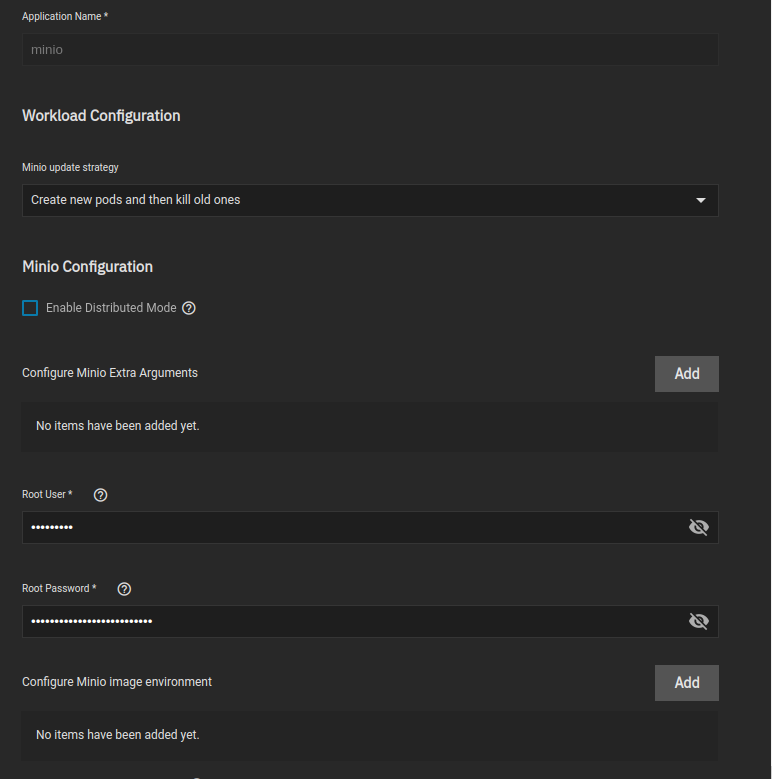

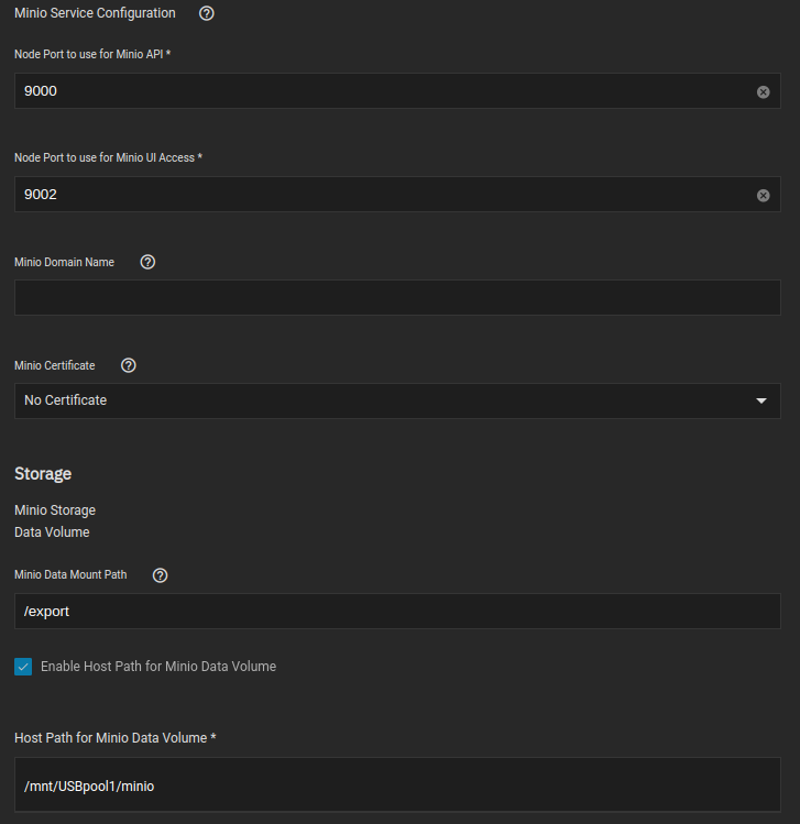

And, here is my Minio configuration: (Sorry for all the screenshots.)

At this point I have both the Minio app and the S3 service running. They appear to have started normally -- no complaints from either one.

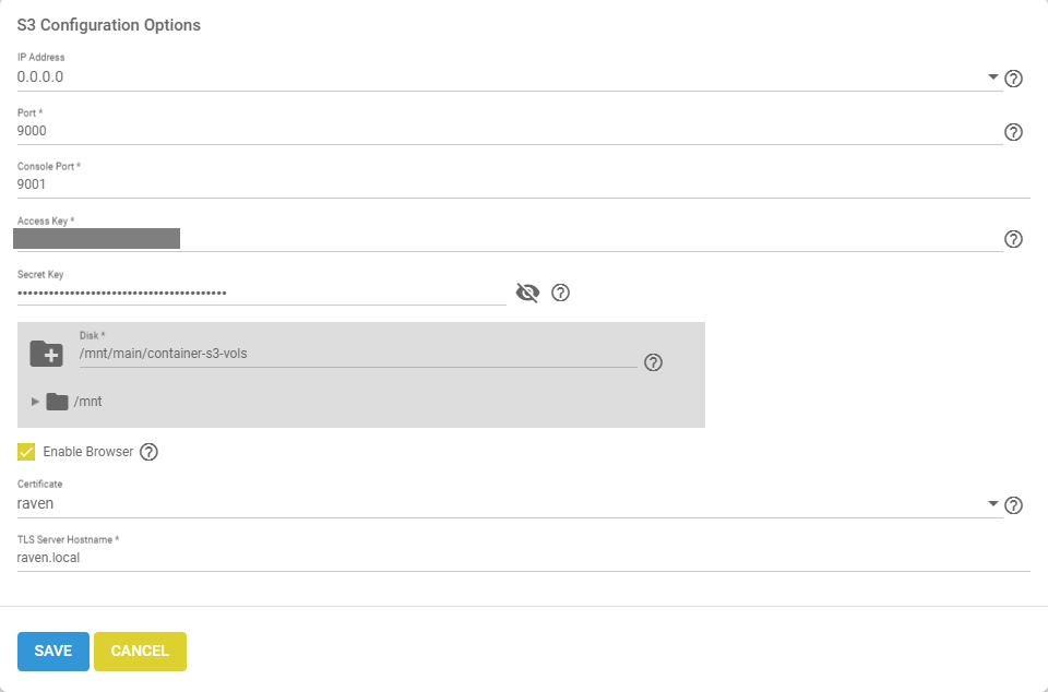

Use the same certificate as under System->General. The service isn't starting because it doesn't have a certificate. Take a look at my S3 service setup:
The certificate is the same as my server cert in System->General. TLS Server Hostname is the CN in the certificate, and should be the FQDN of your server.
