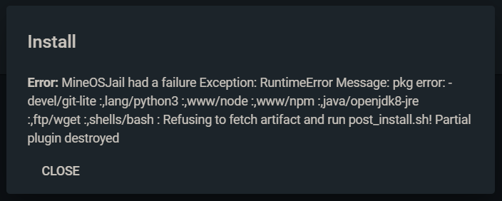

Error: minecraft had a failure Exception: RuntimeError Message: pkg error: - www/node8 :,www/npm-node8 :,java/openjdk8-jre :,ftp/wget :,shells/bash : Refusing to fetch artifact and run post_install.sh! Partial plugin destroyed
i have this error but i don't know how to fix it it exits as soon as i install the plugin and it doesn't let me install it. thx <3

Thank you for your report. It looks like the packages related to node8 were deprecated. I have submitted a bug report to have this fixed.
https://jira.ixsystems.com/browse/NAS-105632
It may take a few days for the fix to make it into the official code. Until then, you can install the plugin from the command line using the following commands:
**no longer relevant**
Please report back and happy mining!
EDIT: This has been fixed in the official plugin repository; workaround no longer relevant
fetch https://raw.githubusercontent.com/jsegaert/iocage-ix-plugins/NAS-105632/mineos.json
iocage fetch -P mineos.json -n mineos-plugin
thx <3
