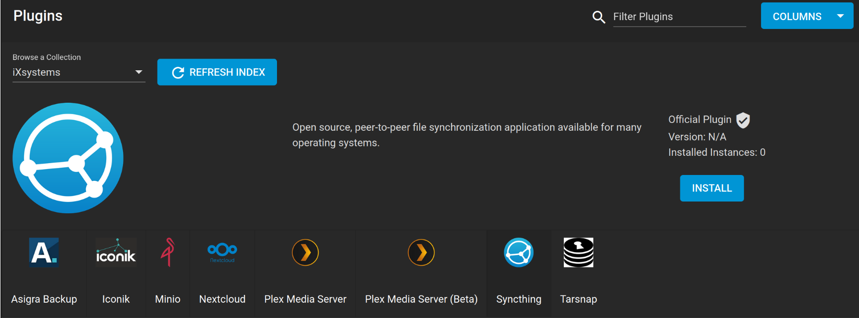

Same error for me as well. I notice that the Version is "N/A" not sure if that's related:
