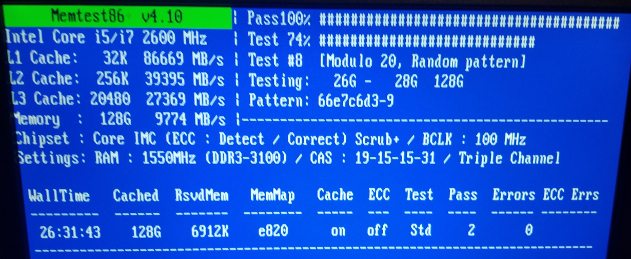

I did a 24 hour memory burn in with memtest86. 3 complete loops no issues so i;m at a loss why his is an issue.

That seems to be showing a memory error, but I would believe that it should have been caught by ECC.
What version of memtest86 did you run?

With that much memory you will probably have to test it for a week. I know it too my system forever to get a full memtest run and I have 128GB also.

Memtest86 v4.10

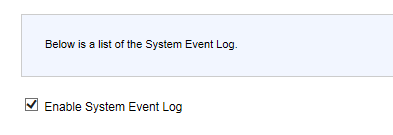

does ipmi tell you banks? Could just guess and remove sticks.
15,504
Anyone have insight on how to identify the different memory banks?
Check the IPMI event log, either through the BIOS or through the IPMI web interface (or, presumably, by using IPMIView).

Memtest86 v4.10
You are not using Memtest86, you're using Memtest86+. Today, they are separate tools, though they both descend from the original Memtest86 v3 code c. 2002.
If you use Memtest86+, you need to use 5.01. Ivy Bridge CPUs were not properly supported in the older versions, and I'm wondering if that's part of your issue. Memtest86 is more updated (Memtest86 v7 supports v6 Xeons and Apollo Lake), but PassMark has made the code proprietary, so it's not open source.

A little off topic; why does it show the E5 as a i5/i7?
Because he's using a version of Memtest86+ that does not properly support Ivy Bridge CPUs.
