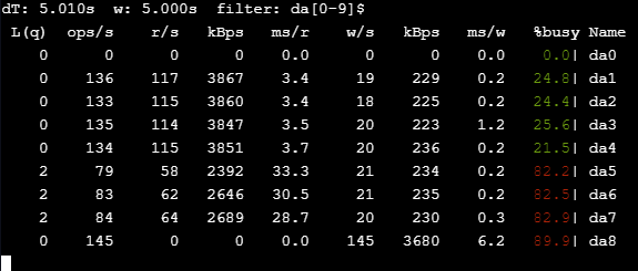

I'm in the process of upgrading my raidz2 array from 3TB to 6TB drives by sequential resilvering. The existing drives are a mix of Seagate, Toshiba, WD, and Hitachi, all 7200 RPM. The replacement drives are all 5400 rpm WD Blue drives (WD60EZAZ, with the larger cache).
gstat is reporting that the WD drives are showing 10x the read latency of the others. da1-4 are existing 7200 rpm 3TB drives, da5-7 are the new WD blues, and da8 is the resilvering target.
My question is this: Why are the read latencies on the WD drives so much higher? That can't be accounted for by just the rotational speed change, can it? Or is it because of the mismatch in rotational speeds between the disks in the array, and it'll go away when they all match again?

I believe the 6TB Blue drives are SMR, there are posts on this forum indicating that the Blue drives with the larger cache (256MB) are SMR drives, which will show that kind of latency.
jgreco
Resident Grinch
May 29, 2011
18,680
I think the EZAZ are SMR drives, not sure. It's probably not true read latency but rather write latency tying up the drive and causing delayed reads.

Okay, that makes a ton of sense, now that I've read up on SMR drives. Turns out I'm behind the times, who knew?
Once I'm done upgrading the array, would it be helpful to implement a SLOG device? That would eliminate the overwriting penalty on at least the ZIL stage of a write op, right?. I haven't felt the need to use one yet, but this is a different class of performance issue than I've dealt with.
