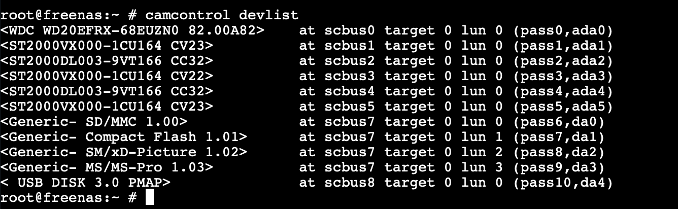

When I got the alert about the degraded pool, I looked at the disks themselves and discovered that ad2 was missing from "camcontrol devlist". It just wasn't there to be seen.
Thinking I might have a dodgy cable (the system has been running untouched for 1 year +) I replaced both the power and data cable (SATA) to no avail. The system just wasn't seeing ada2.
I replaced ada2 with a new(er) drive of same capacity, after shutting down.
Upon reboot, I saw nothing new happening and it seemed like there was nothing going on. The disk, however, was now visible:

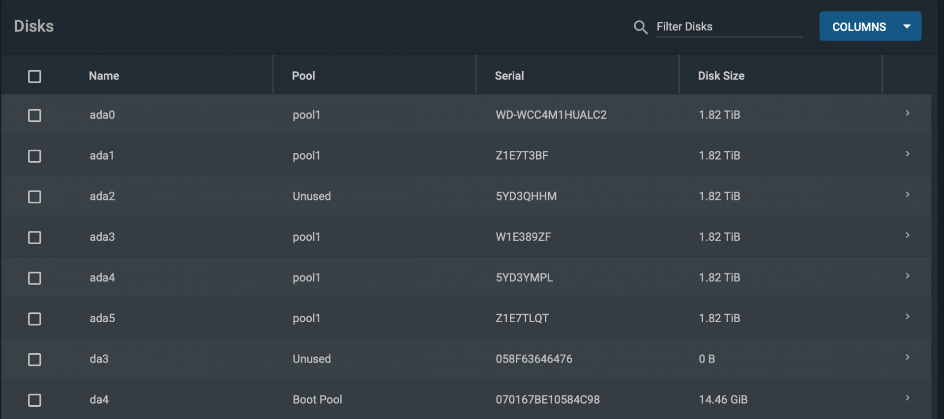

But, when I look at the "Disks" option in "Storage" I see,
It shows ada2 to be "unused".
I don't see any options to either:
1. Add it to pool1 (which is my main goal)
2. Make it "useful"
The disk was wiped with a third party utility outside of Freenas, which I understand has a wipe function built in. Do I need to format it, and if so with what file system?
I don't see any options to add this disk to my pool to fix the degrade problem.
