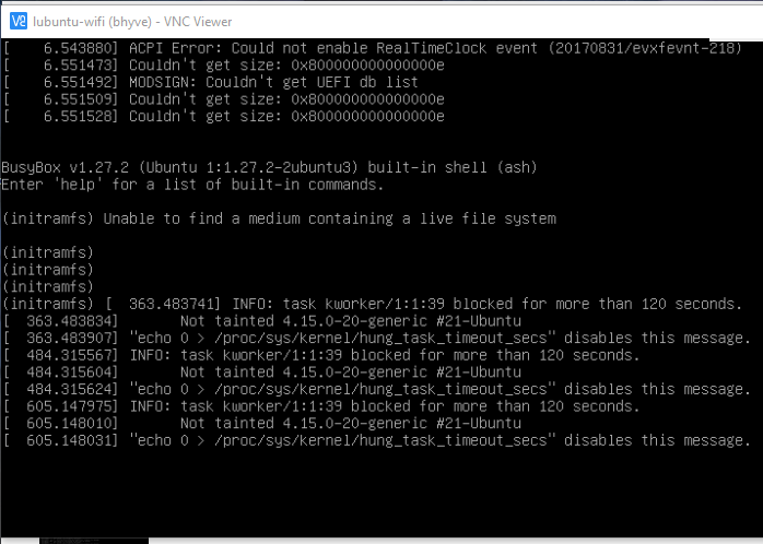

Lubuntu and Ubuntu will not install as VM
fonque
Jun 19, 2018
4
I have been trying for a few hours to try and get Lubuntu or Ubuntu to install as a VM on my freenas box. I have a attached a copy of the errors I get when attempting an install.
The main error is "unable to find medium containing a live file system".
I need some suggestions on how to troubleshoot this. I have a 50GB zvol. I tried as both AHCI and VirtIO. Same result. I also tried UEFI and UEFI-CSM. UEFI-CSM doesnt work at all, just get a blank screen. I also tried setting the permissions on the .iso file to be owned by root:wheel. That also made no difference.
Any help is appreciated.

yes its the latest version 18.04 and I think you might be right. When I get some time I will try again with an older iso prior to 4.15 kernel.

FreeNAS fixed this issue a while back. Just have to wait from them to get around to releasing it.

I installed lubuntu 16.04 LTS and all is well. I had to go back that far to get mondodb to play nice with Unifi controller. I wasnt having much luck using the latest and greatest.

Any idea when they will be releasing the fix for this?
meku
May 4, 2014
34
It is fixed in 11.2-beta, I don't think it is possible to predict when 11.2-stable will be released.
