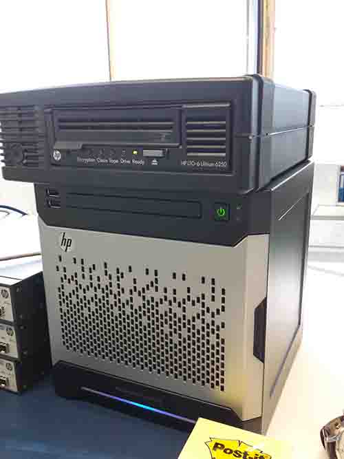

@xcom thanks for that lead, I was starting to fiddle around with the jail to keep things on a separate dataset (ended up leaving it as is since it *is* already on a separate dataset by default), and was afraid the device would not be properly exposed. Your hint saved me quite some time here / made me push forward :)
From this point I want to perform some more tests with bacula, I am checking their documentation at the moment in order to ensure that data gets written properly and gets read properly.
This is with the "new" HP LTO6 drive (external) running via an HP H222 on a MicroG8.

This paired with a MicroServer G8 is setting up for a nice export system.
HBA replaced but not with a M1015 (went all the way HP here, not messing with the hardware), its a P2XX something.
Since it is a system with 4HDD, I am considering a mirrored pool over ZFS2 (have to check this on the next step).
