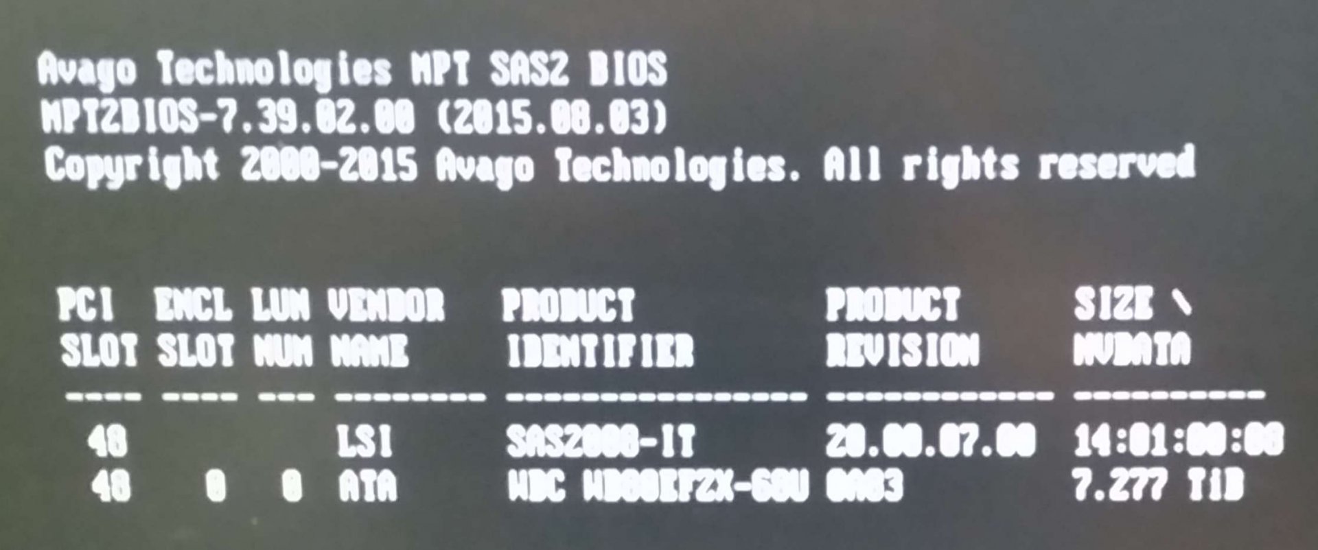

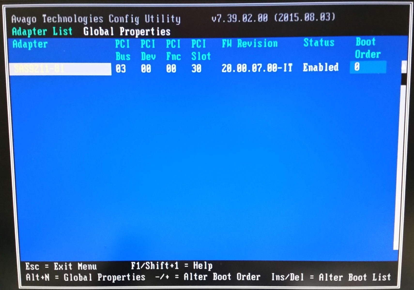

As promised I'm reporting back on the HBA mentioned above:
http://www.ebay.com/itm/New-IT-Mode...-PCI-E-Card-Bulk-pack-US-Seller-/291641245650
I'm hoping that the info will be useful to others, and also to get some guidance on how to move forward with this device.
Since it will be a few weeks before I will have the time to rebuild my FreeNAS, and I can't afford to have extended downtime, I decided to do initial testing of the device on my Linux Mint box. I installed the card and have been successfully running badblocks on a new drive for approximately a week - so the card clearly works. I'll include the information about the card that I have obtained from the linux system.
Questions:
  1. From the information provided does it look as if this card is ready to use as is, or will I need to flash new firmware?
  2. Is there a way I can test this card for compatibility with FreeNAS (likely with 9.10.2-U5) with some sort of bootable USB? So that I don't have to dismantle my current system, I'd like to be able to just boot the current test system (if possible without disconnecting the linux disks that are connected to the motherboard, but if necessary I can pull the cables) and just run a few quick tests to know if things will work?
  3. Any advice/comments about this piece of hardware? I've built several PCs over the last 20 years, but I'm a complete noob with this type of commercial grade hardware and have very limited BSD experience, so if someone can point me in the right direction it would be a big help and would be appreciated!
BIOS BOOT SCREEN

SETUP UTILITY AVAILABLE DURING BOOT
index.php
The information dumped from the card follows:
lspci
03:00.0 Serial Attached SCSI controller: LSI Logic / Symbios Logic SAS2008 PCI-Express Fusion-MPT SAS-2 [Falcon] (rev 03)
Stux
Jun 2, 2016
4,419
Its running 20.0.7 IT firmware. Seems right.

The vendor said he had a P20, and that's what I asked for... nice to know that's what I got and that I can hopefully skip the flashing step(s).
I never heard of Avago Technologies, is that the normal BIOS for this card? Or is this some sort of clone?
