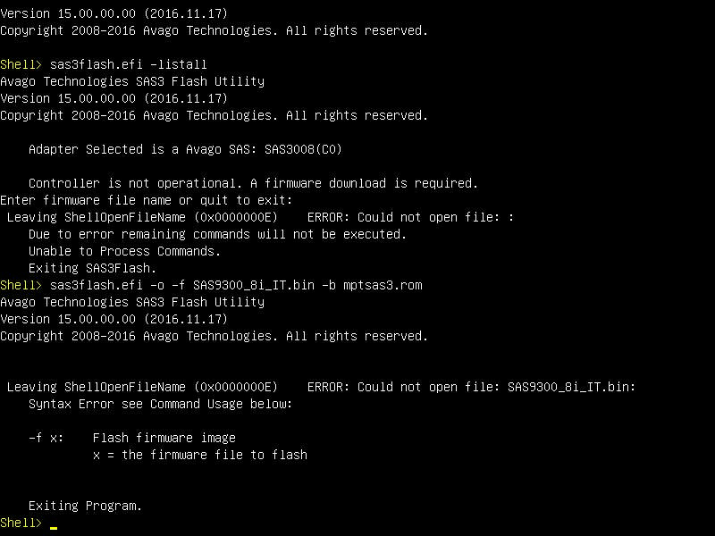

Hi there, as stated here, I have a big problem with my new NAS... LSI not working
I wanted to post here as my follow up problem is hardware specific to flashing a LSI card... (Broadcom SAS 9300-8i, PCIe 3.0 x8 (LSI00344))

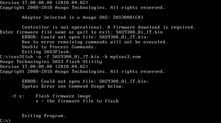

I tried two computers after the first one wouldn't budge at all. The results on both in EFI or normal are the same:
Any hints what could be the problem?

In the first case, it looks as though the sas3flsh program cannot find the firmware file. If the file actually exists in the current working directory from which sas3flsh was executed, this may be because of the long filename you gave it. Try renaming it with an '8.3' filename (e.g., 93008iit.bin and see if that works.
In the second case, the same filename problem may apply: I thought that UEFI shells could handle longer filenames, but 'm not certain about that.

Thanks a lot! I tried it again with 93008iit.bin and it didn't work. I then tried 9300it.bin and it actually worked! I really don't get why the official name when downloading the file is so long if it's such a problem...
