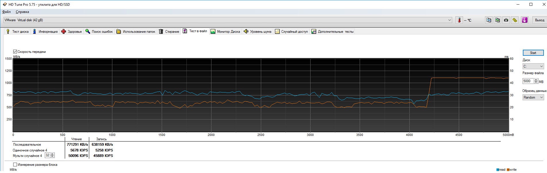

I have one NVME PCI-E SSD - PLEXTOR 1TB (PX-1TM9PeY)
If i tested perfomance in my comuter (windows) and i get a performance of about 3 gigabytes read and 2 gigabytes write.
I created a pool from this disk in freenas, and share to iscsi over 10Gbit/sec, and if i tested perfomance in freenas server, i get a performance of about 850 megabytes read and 700 megabytes write (see screenshot).
Deduplication is disabled, compression of lz4 (default).
Disabling synchronization and atime does not give anything.
I understand that i run into 10 gigabits of the network for reading, but I do not understand why the write speed does not run into 10 Gbit/sec limit?
I planned use PLEXTOR disk for the pool cache, but my current disks in the pool show about the same write speed result, which makes it meaningless to use it in principle.
thx for any help.

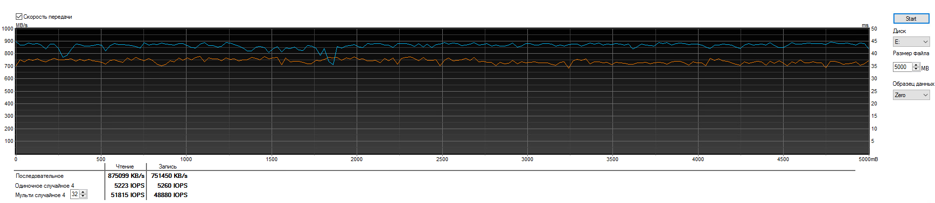

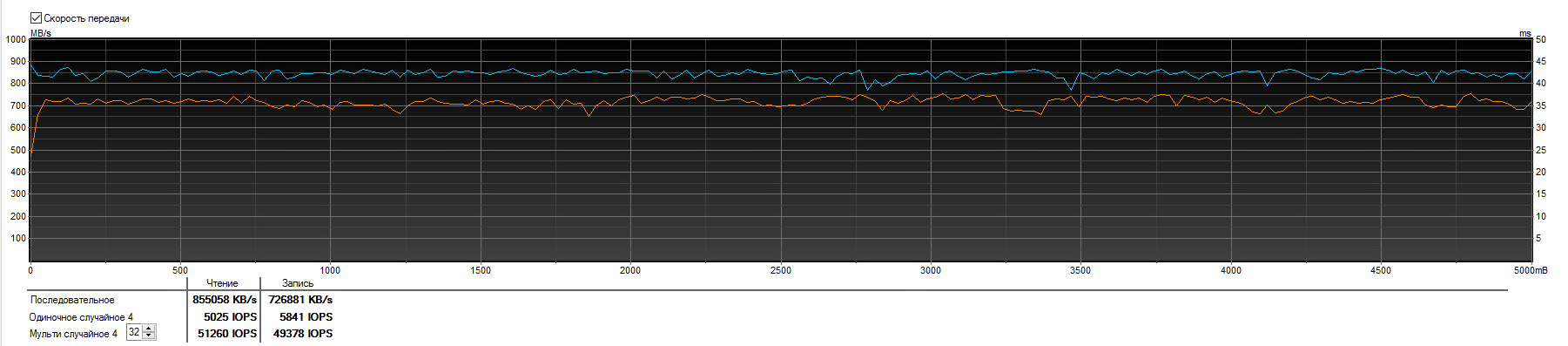

as43031
Aug 10, 2020
29
You need mirrored pairs (as many as you can) to increase the IOPS of your pool. Currently with a RAIDZ pool, you have only the IOPS of a single disk.
I ran an experiment and the results surprised me. All variants have the same result
Any idea why this is so?
ssd - 960GB SSD INTEL DC D3-S4510

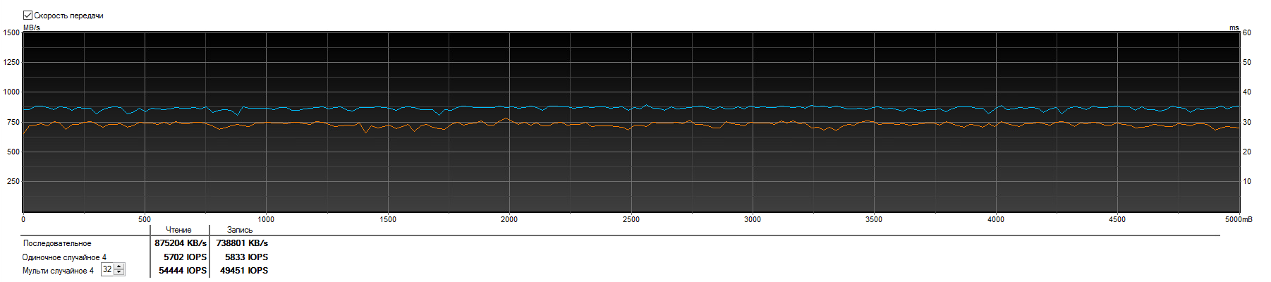

as43031
Aug 10, 2020
29
okay we're a little distracted
I created a pool: 5 vdevs (2 ssd each Intel 960GB DC D3-4510 SATA-3 in the mirror)
I shared this pool using an iscsi and got the result - see the screenshot, no idea why? I expected to run into the network bandwidth, but this did not happen.
The SYLOG and Cache device were not used.
9,700
If you're only testing with a single client/thread (equivalent to a single VM doing a lot of writes), then you're not going to see the benefit of the extra IOPS you get with a pool of mirrors. You need to simulate more realistic load with the tools that @HoneyBadger suggested.
