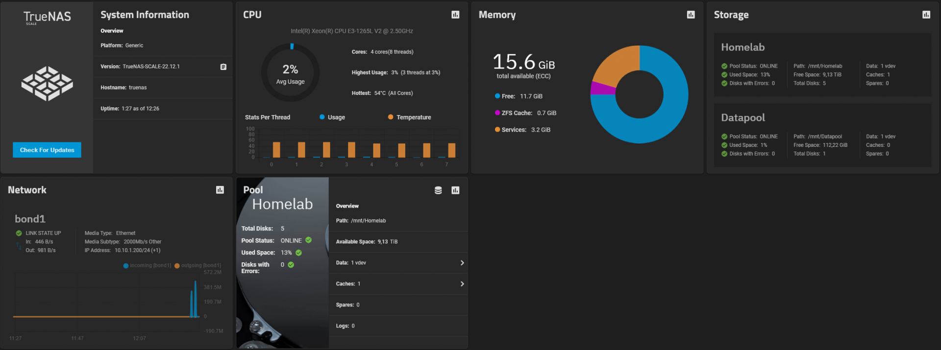

here are some Screenshots from my config & testing:
Setup:

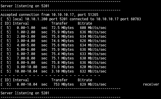

Iperf3 Test from my MainPC (2,5Gbit Nic - NVME SSD) to Truenas

You can forget about that, you're just wasting your time on that.

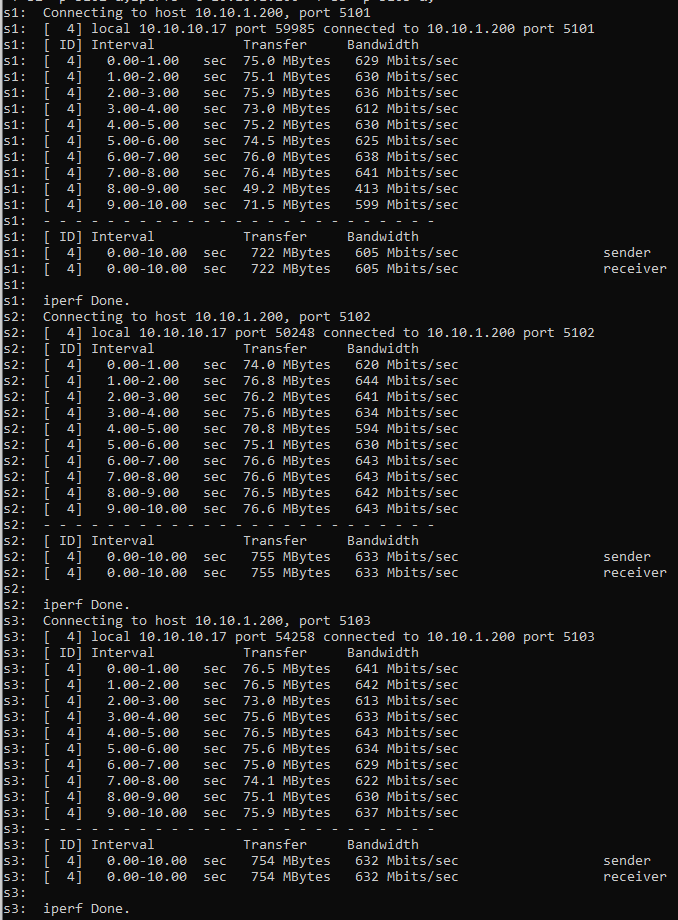

What happens if you do 2-3 streams in iPerf?
Dodgy, was the same desktop in use before when you were getting line speed out of the server?
I had the same Client with same components before (2,5Gbit onboard nic)
Truenas iperf3 multi
iperf3 multi from PC
i hope i done it right, im just starded with linux stuff

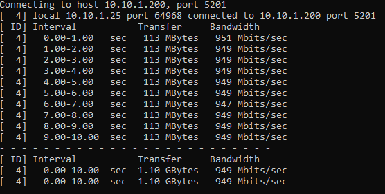

seems like i found the "Problem" but still dont understand it, maybe someone could provide me some Infos:
out of curiosity i switched back to Truenas Core V13 and had the same issue & after some tinkering i switched my PC into the same VLAN as my NAS from 10.10.10.x to 10.10.1.x and everything work as expected..
but WHY? i cant imagine just loosing half of bandwith for routing ? my firewall is an Opnsense
Well, clearly your router can't keep up. "Why" is a different question, but we don't have much of anything to go on.
