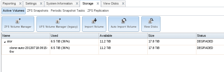

[smurfy@nas] /# zpool import -D -R /mnt stor
[smurfy@nas] /# zpool status
  pool: stor
state: ONLINE
  scan: scrub repaired 0 in 6h26m with 0 errors on Tue Jul 16 04:05:44 2013
config:
NAME                                            STATE    READ WRITE CKSUM
stor                                            ONLINE      0    0    0
raidz1-0                                      ONLINE      0    0    0
  gptid/8193e730-6aab-11e2-9f2f-00248c450018  ONLINE      0    0    0
  gptid/81f6b150-6aab-11e2-9f2f-00248c450018  ONLINE      0    0    0
  gptid/8255a13f-6aab-11e2-9f2f-00248c450018  ONLINE      0    0    0
  gptid/8402337d-6aab-11e2-9f2f-00248c450018  ONLINE      0    0    0
  gptid/8470dafe-6aab-11e2-9f2f-00248c450018  ONLINE      0    0    0
raidz1-1                                      ONLINE      0    0    0
  gptid/7ff753f5-edb7-11e2-b265-00248c450018  ONLINE      0    0    0
  gptid/805c1416-edb7-11e2-b265-00248c450018  ONLINE      0    0    0
  gptid/80c4b729-edb7-11e2-b265-00248c450018  ONLINE      0    0    0
  gptid/812e5515-edb7-11e2-b265-00248c450018  ONLINE      0    0    0
  gptid/8197afa9-edb7-11e2-b265-00248c450018  ONLINE      0    0    0
errors: No known data errors
[smurfy@nas] /#

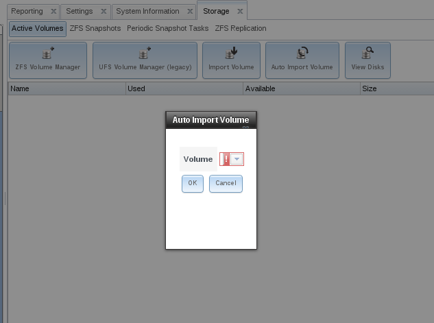

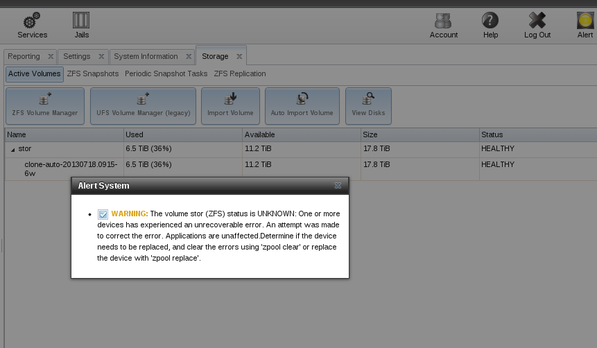

the only thing left is to get it to auto import, right? or should/could i do a zfs send to a hand full of external drives?

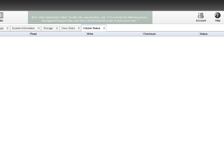

papageorgi
Jul 16, 2013
51
hazah! i got it to work with so much of your help delphij! thanks so much!
i swapped one of the drives with a similar but it had a different sector setup. the pool showed up as degraded. i did try to have it resilver onto the other drive but i couldn't seem to do so....oh well, i'm backing up data and may be done by the time this is read. at that point i will have a full backup and will erase and recreate the pool with identical drives to re-upload the data from the full backup.
again, thank you so much for all your efforts.
delphij
FreeNAS Core Team
Jan 10, 2012
37
Yes. You can do 'zpool export' than use automatic import.
It's recommended to backup and recreate your pool because performance reasons.
