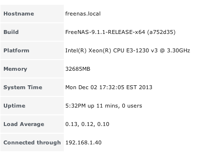

I'm running this system & version of freenas:

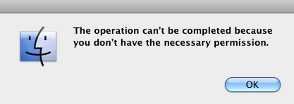

But here's the big issue: Next, I went to my Mac and tried logging into the freenas box the same way I had been doing so for weeks using my original login (Apple AFP share and service still enabled) and though I can log in I have now LOST THE ABILITY TO CREATE FOLDERS OR OTHERWISE WRITE FILES TO THE FREENAS BOX.

BTW, if this helps with fixing the problem, I just noticed that I have only lost write permissions to the HOME DIRECTORY. If I drill down I can still create folders.
So now I'm not going to touch CIFS anymore as I still have lots of files to bring over to the freenas box. Using only AFP and running on a mac, how do I now restore my write permission to my home director on the freenas box?
