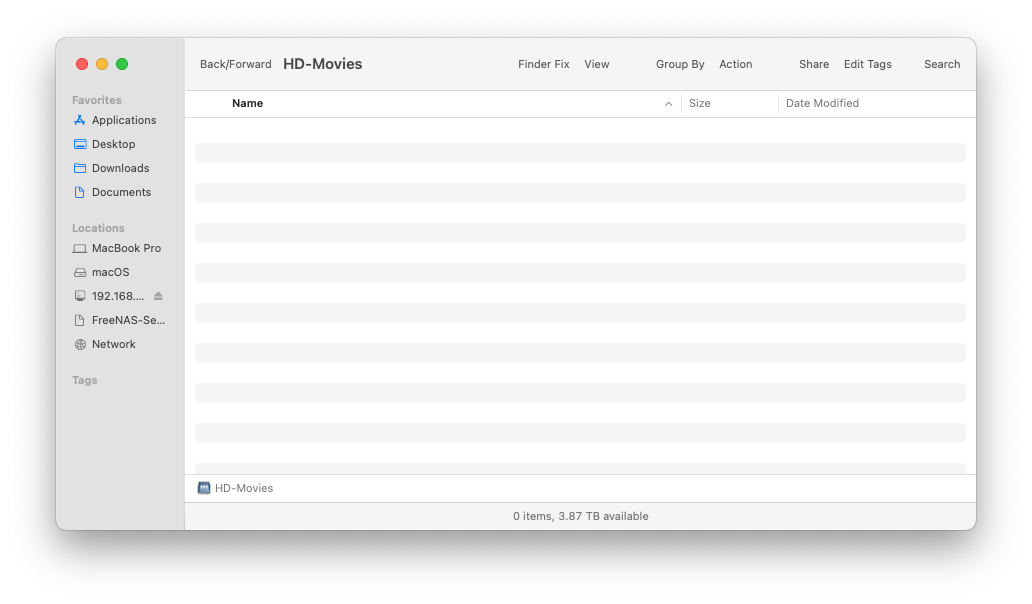

I was in the process of setting up a jail for Plex, and in doing so somehow the permissions on one of my datasets on a Pool got messed up.
When mounting to the share in macOS using the username/password created in the TrueNAS GUI, it shows 0 files, yet the available space shows that about 80% is used. The "bad" dataset is HD-Movies.

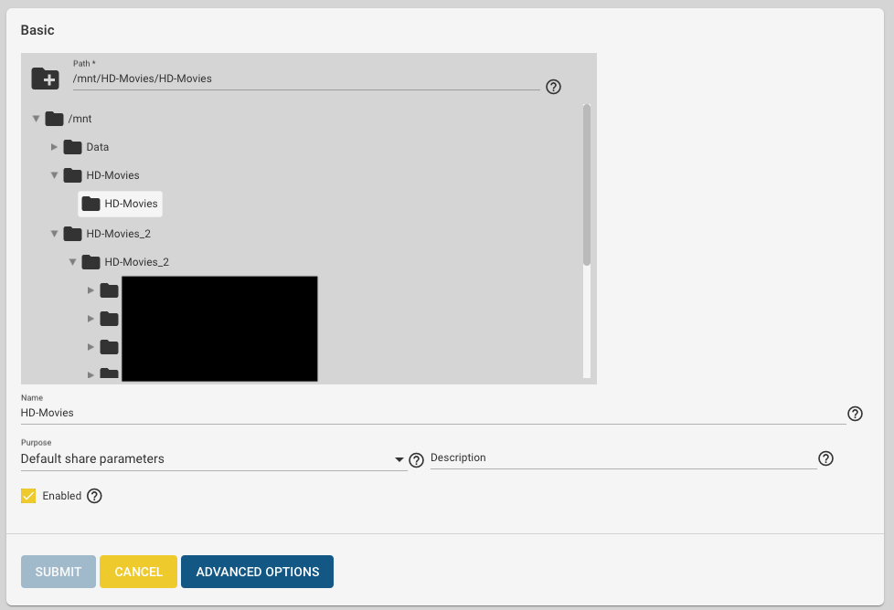

Not sure if it's a good thing or bad, but while poking around & noticed that if I try to set up a new SMB share using that dataset, I can't even see subfolders thru TrueNAS GUI that were made on the share

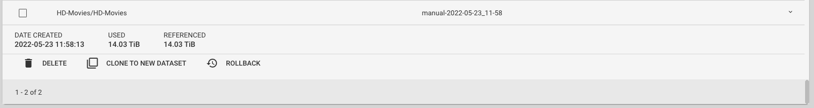

Samuel Tai
Apr 24, 2020
5,399
OK, it does appear you have snapshots of this dataset you could use to recover your data. The usedbysnapshots property shows 14TB. Do you see snapshots available under Storage->Snapshots?
