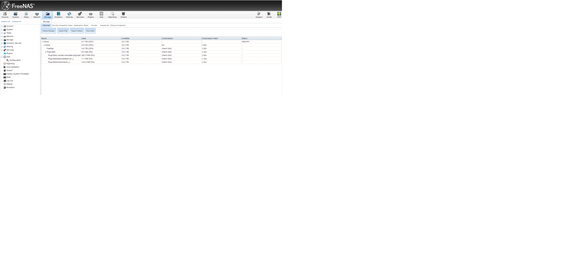

Step 1: import volume
Step 2:Don't Decrypt
Now the volumes are visible and seem to be holding up to what I last remember.
Notice the Jails are still showing data and under the jail and plugins its blank on the GUI. Last time I remember having a lot of issues touching jails after installing them.
So should I ignore these and setup cifs/plex/transmission as if its a new install or something else?
I am already happy running everything fine.. YAY.. TY jgreco (I love the grinch dp)
