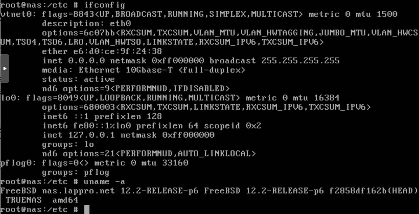

See ifconfig response and a uname -a for version info:
Now I've been looking in /etc/rc* file for network config and couldn't find any.
Because I thought I needed to set the vtnet0 network interface to DHCP or simply the new network ip range.

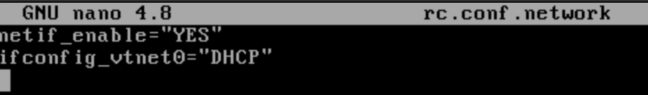

I've tried setting something up in /etc/rc.conf.network, and setting netif_enable to yes, but without results so far:

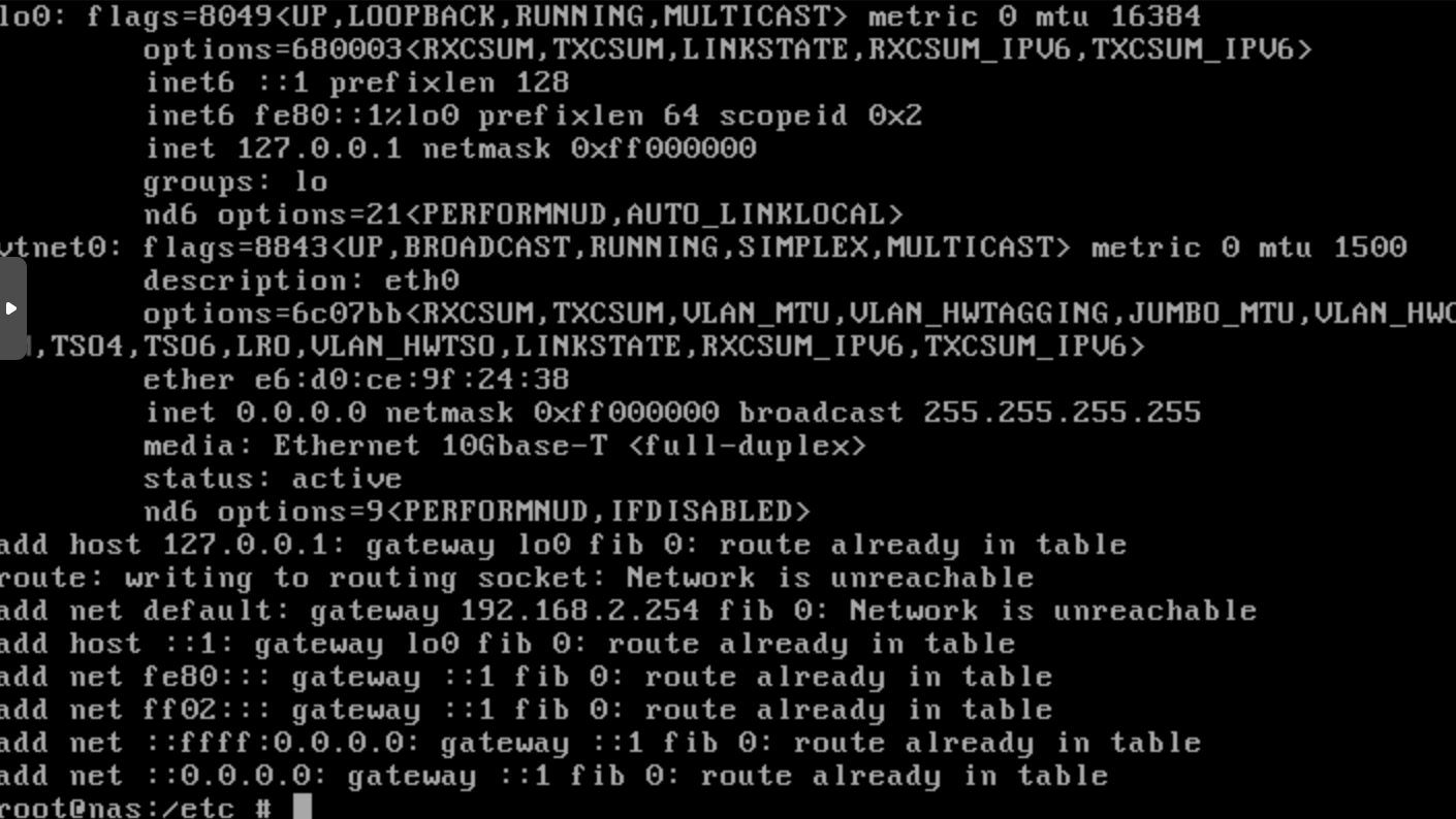

Trying to start the network with /etc/netstart throws some network unreachable errors:
Trying a netif restart shows a DHCP connection attempt, but eventually fails: /etc/rc.d/netif restart
