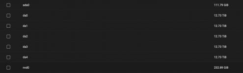

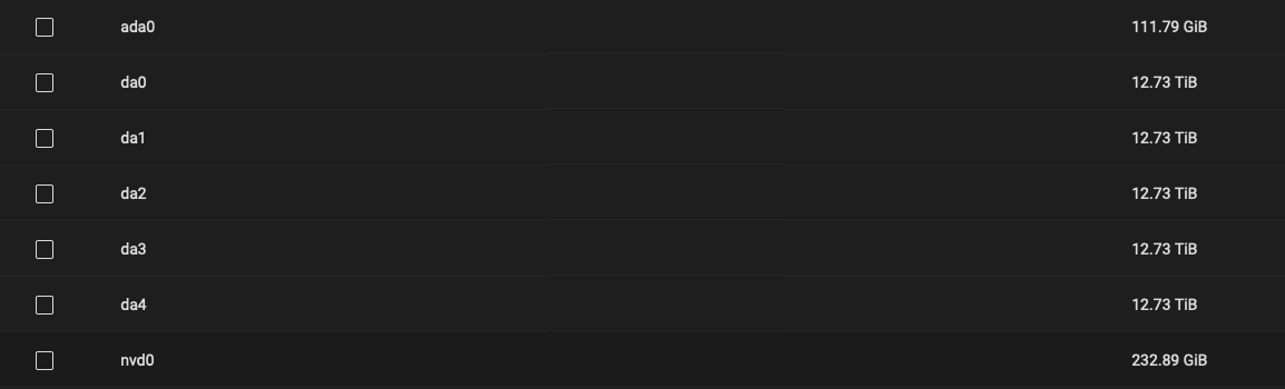

My Budget "friendly" setup (without disks/sas adapter)
case: SilverStone SST-CS380 V2 149 euro (cheap but does its job)
Ryzen 7 3700X - I think this MB will support Ryzen 5
MB: ASUS TUF GAMING B450-PLUS II, socket AM4 115 euro
Cpu FAN: Noctua NH-D9L 60 euro
RAM: 4 x corsair vengence LPX 32GB 560 euro
NVIDIA GeForce GT 710 PCIe x1 (the only one I found to keep a PCIe 16 available )
its not a server setup but desktop and serves me well with many things running

Given that I am going to use SATA drivers, would you recommend using an addon card or the on-board controller would be sufficient if I go with a X570 motherboard?
ramib
Dec 31, 2019
41
Thanks!
I have this card for over 10y and its still working good
support 8x sata 6 drives , I use also sata drives
It was many years ago but I replaced the controller firmware to have JBOD support
google it, its an old topic
The MB I picked since its supports 128GB that's all.
