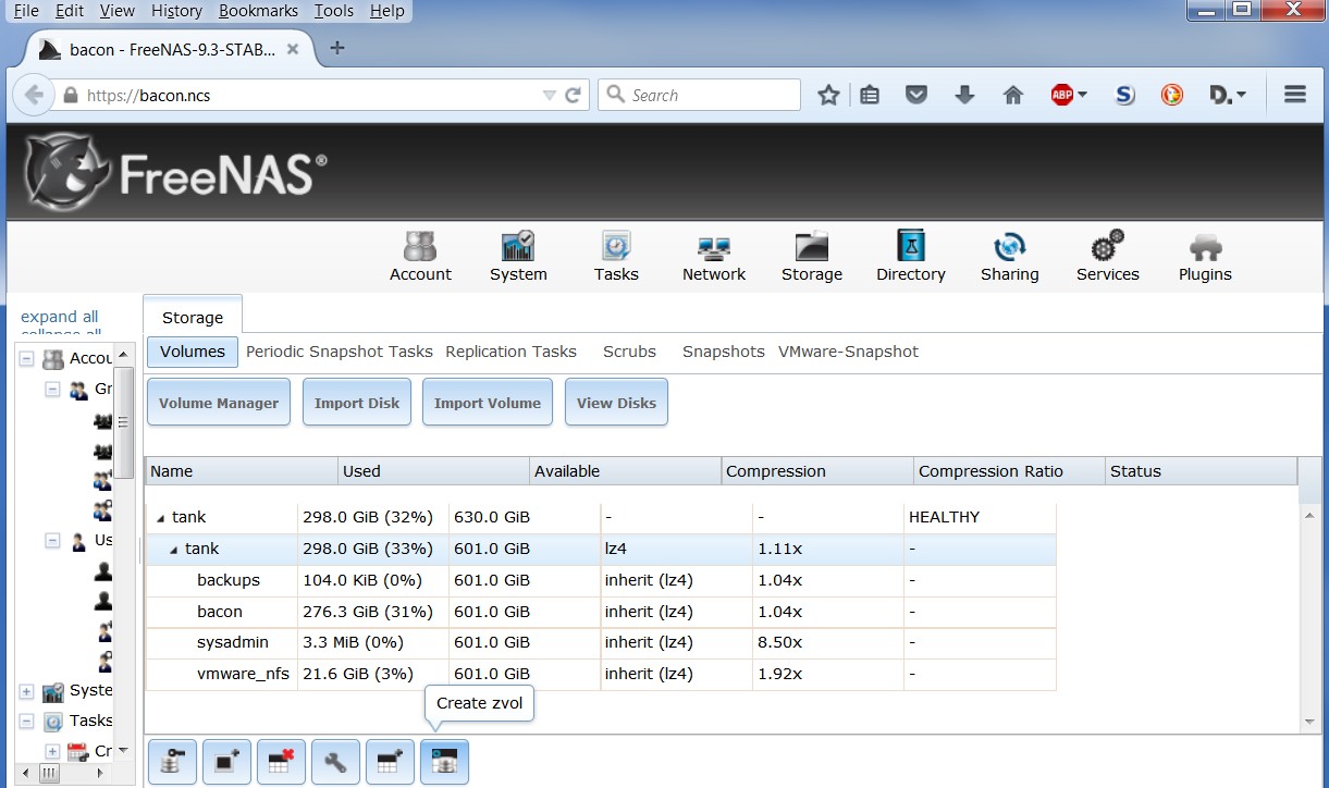

With 6 drives I suggest you use either a RAIDZ2 pool (for more storage) or 3 striped mirrors (for more IOPS). In either case you will want to create a ZVOL dataset for the iSCSI share (see screenshot):

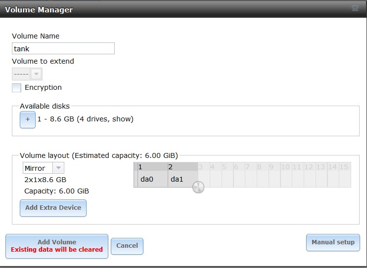

To create a RAIDZ2 pool, use Storage -> Volume Manager, name the pool, select all six of your disks, then choose RaidZ2 from the Volume Layout dropdown.

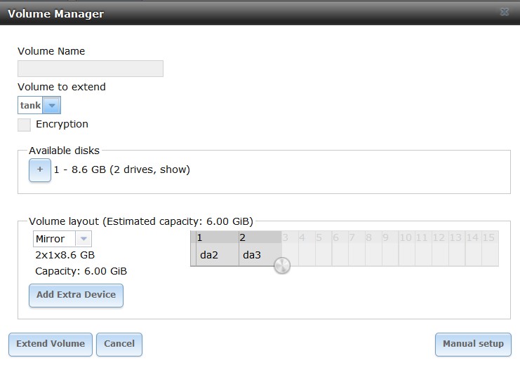

It's a little trickier to create a pool of striped mirrors. Using Volume Manager, specify the pool name, choose two disks by dragging the Volume layout gizmo, and make sure Mirror is selected as the type. Then run the Volume Manager again, but specify the pool you just created in the 'Volume to extend' field. Select the next two disks and then extend the volume. Repeat for the last of two disks and you're finished. This is all harder to explain than it is to do, hopefully these screenshots will help.
Creating the pool:
Extending the pool:
