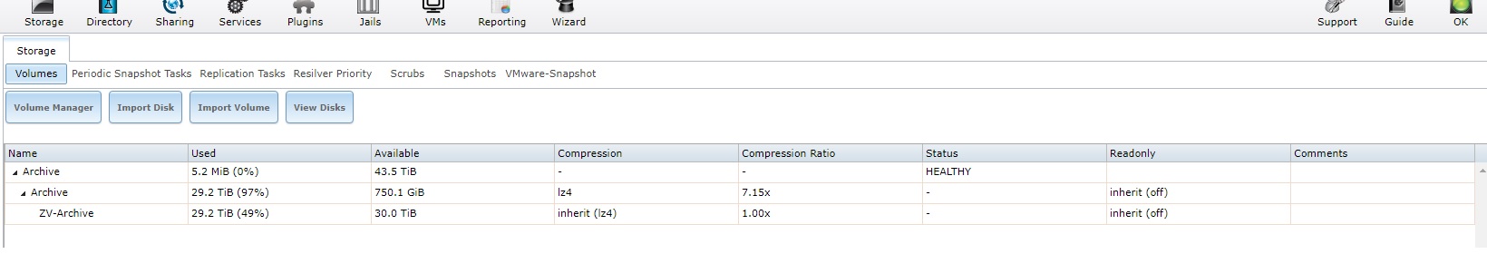

Why are you splitting it into multiple datasets? Based on what you've posted here, I'm not seeing a benefit to multiple datasets. I'm wondering if this is a holdover from the iSCSI thinking.
Antairus
Dec 7, 2017
24
OMG Yes. I have to quit that don't I.
Nick2253
Apr 21, 2014
1,633
You'll still want to make a sub dataset. The hierarchy that you are seeing is:
Archive (the pool) -> Archive (the root dataset) -> ZVx (sub dataset).
Directly sharing the root dataset is not a supported configuration, so you'd want to create a single sub dataset (like ZV1), and then you'd share that.
Antairus
Dec 7, 2017
24
Ok hows this. I will split my shares on the ZV-Archive.
Nick2253
Apr 21, 2014
1,633
Looks good.

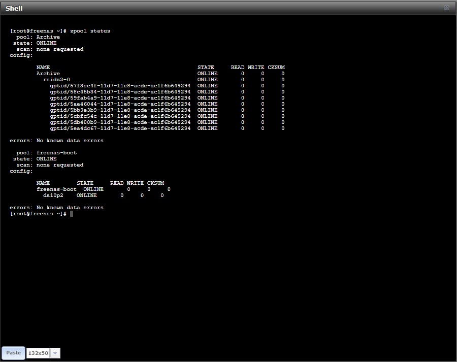

Post the results of zpool status
