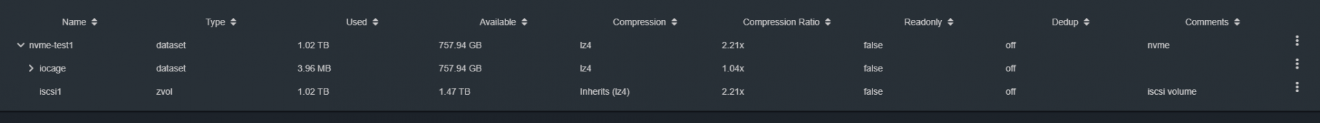

HI! I have a problem. Im testing how FreeNas 11.2 work
I make:
And I want extend this zvol. But when I try to extend I see error:
Why ?!
Because 1.4 [TB] / 1.7 [TB] = 0.82, or 82%. Note that 82% is a greater value than 80%, which is why you're getting a red warning message warning you not to exceed 80%.
Is the warning there before you edit any options?
So, what's the sequence of steps that causes the warning to show with values that would not result in more than 80% usage?
I retry FreeNas 11.2 server as VM (Hyper-V) with simmilar configuration.
The result is the same :(
Extend size work only with "Force size" checkbox used.
Why doesn't it like 1300 GB!?
