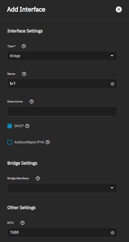

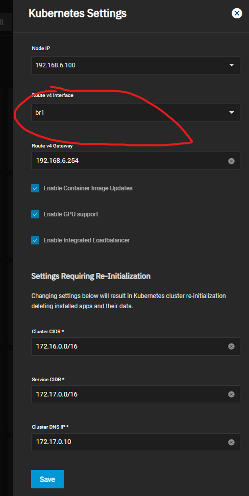

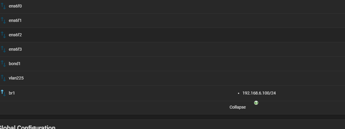

u need to set a bridge, without vm´s and apps can not connect direct to Truenas Host (if in the same IP Range)
u create a bridge on "main" network nic, and u need to move the main ip to the bridge.(all connections going over the bridge)
dont forget to switch apps to the bridge.

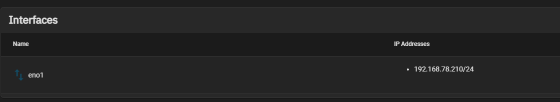

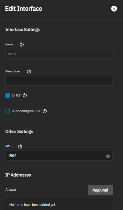

Hi, I tried your configuration I removed the dhcp check from my eno1 network card, I created the bridge and I put it as per your screen. Then I applied the changes but it didn't work, the apps kept running while it was no longer accessible truenas than in my things and 192.168.78.210.
After a few minutes everything is back to normal, I believe that truenas has not applied the change because I no longer have the bridge connection.
Am I wrong something?
