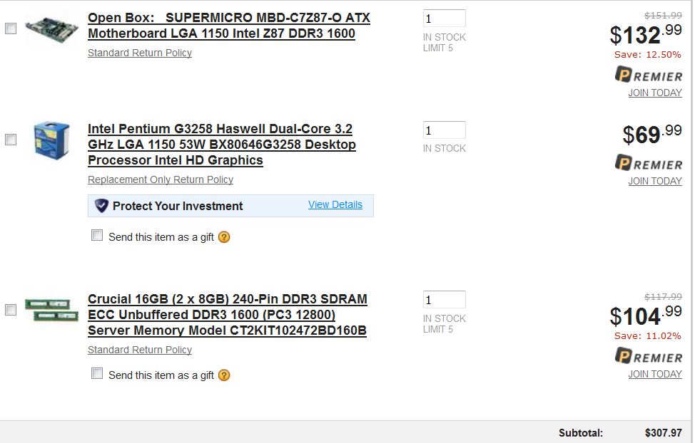

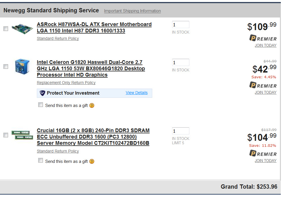

I just put together a $250 build in the pic below. If you guys don't mind,
1. I can get this down to $220 with an open box mobo. Does open-box make you quiver like I do?
2. All I want to do is share folders and have a RAID5 (RAIDZ) 20TB setup with data integrity in mind. Would I benefit in any way by getting a better cpu? Would build times, scrubbing, error checking, etc be a factor with a low cpu? If I ever want to run plugins and transcode and do any of that stuff in the future I would rather buy a new CPU. But for now I would like it to be as green and as cheap as possible.
I understand I am buying the cheapest stuff out there. I don't expect it to work miracles.

Oh good catch. Thanks. Why would a server mobo not support ecc?!?
I liked that one becuase of the 8 sata and of course the price.

anodos
Sambassador
Mar 6, 2014
9,553
A better question is "who labels an H87-based motherboard as something for servers?"
Note that the "server" motherboard has dual realtek RTL8111E and in the newegg page states "Xeon processor E3-1200 v3 series processor support is an extended advantage provided by ASRock Rack. It is out of warranty, user's discretion is required." That is the most weaselly-worded server "feature" I've ever seen. It's just nuts.
"We have added this feature, but if you use it won't stand behind it and may void your warranty. It for servers, hur, hur, hur." It seems like they tried to bolt-on some "server" features to a desktop chipset to make it checklist-compliant. Kinda makes you question the rest of their 'asrock rack' product line.
Maybe someone with more hardware knowledge can enlighten me.
TheKiwi
Dec 27, 2015
54
Both the boards are different. The Supermicro you linked isn't a server board at all, or a workstation one really. It looks exactly like a X10-SAE workstation board with the server chipset replaced with the equivalent z-series overclocking chipset. So it swaps the ECC and workstation features for overclocking support.
As for the Asrock, they claim it's a server board but it's basically a cut-down desktop board with a few small tweaks and validated for server operating systems. They've tested it with Xeons, but won't say it's actually supported, probably because Intel doesn't let them advertise a board with a desktop chipset as supporting Xeon. I imagine it would be useful for some low-cost hosting situations where you don't need server-grade features or ECC.
