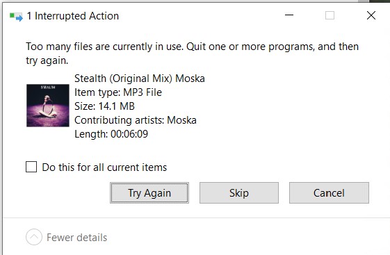

Hi everyone,
I am trying to transfer around 1.10 tb (150,000 files), from a volume mounted as a disk to a Windows VM, to a mounted share in that Windows VM.
Small transfers work fine, but with this transfer, it pauses from time to time, with the error “Too many files are currently in use. Quit one or more programs, and then try again.” Most of the time when trying again, the transfer continues. The VM resources don’t seem to be a problem.

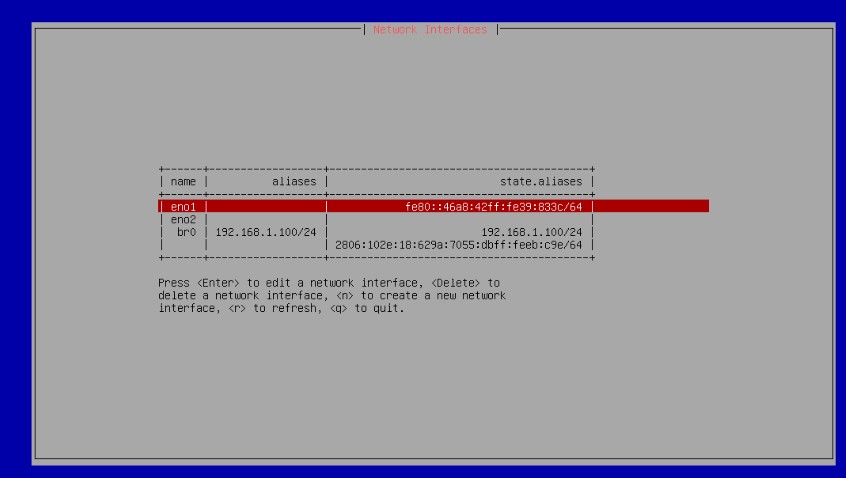

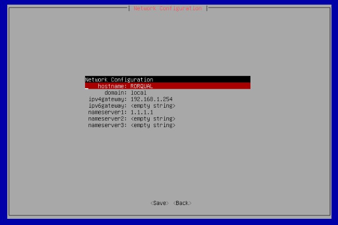

I have TrueNAS configured with a bridge connecting the main interface and have a static IP. MTU is set to 1500, and I have no idea if this should be changed. I had to use a bridge to access the shares within VMs (I read that was the way of doing it). By the way, my nameserver is set to 1.1.1.1

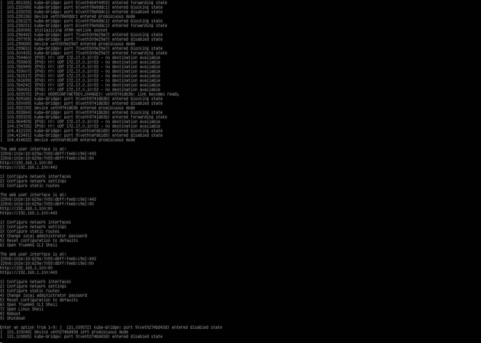

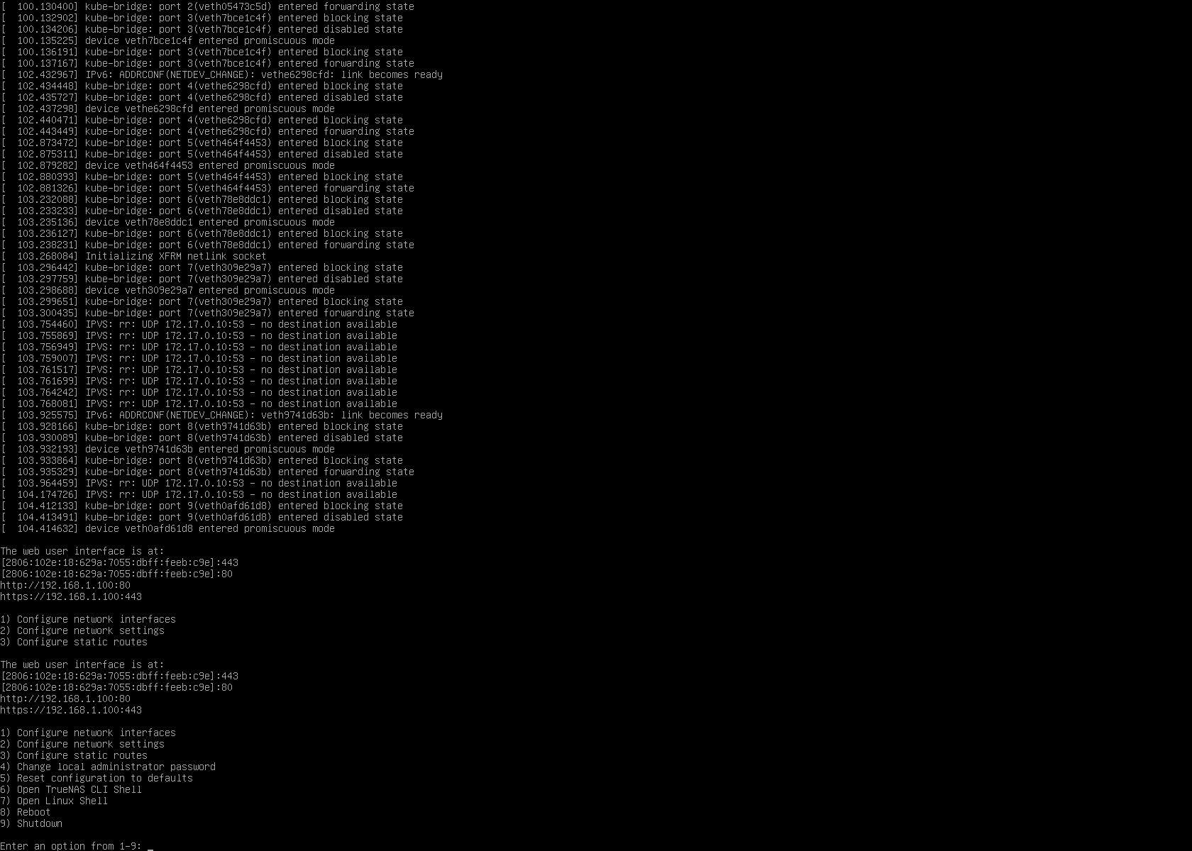

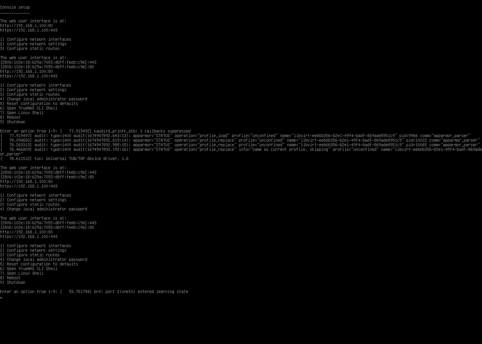

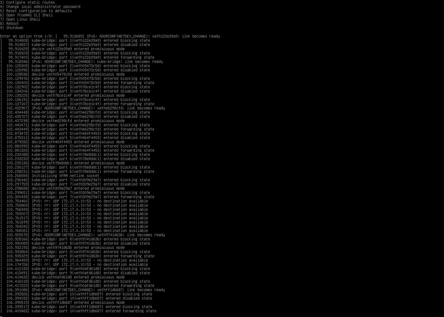

Another thing that I noticed is some weird errors on the main console, here you can take a look at the debug info, and some screenshots

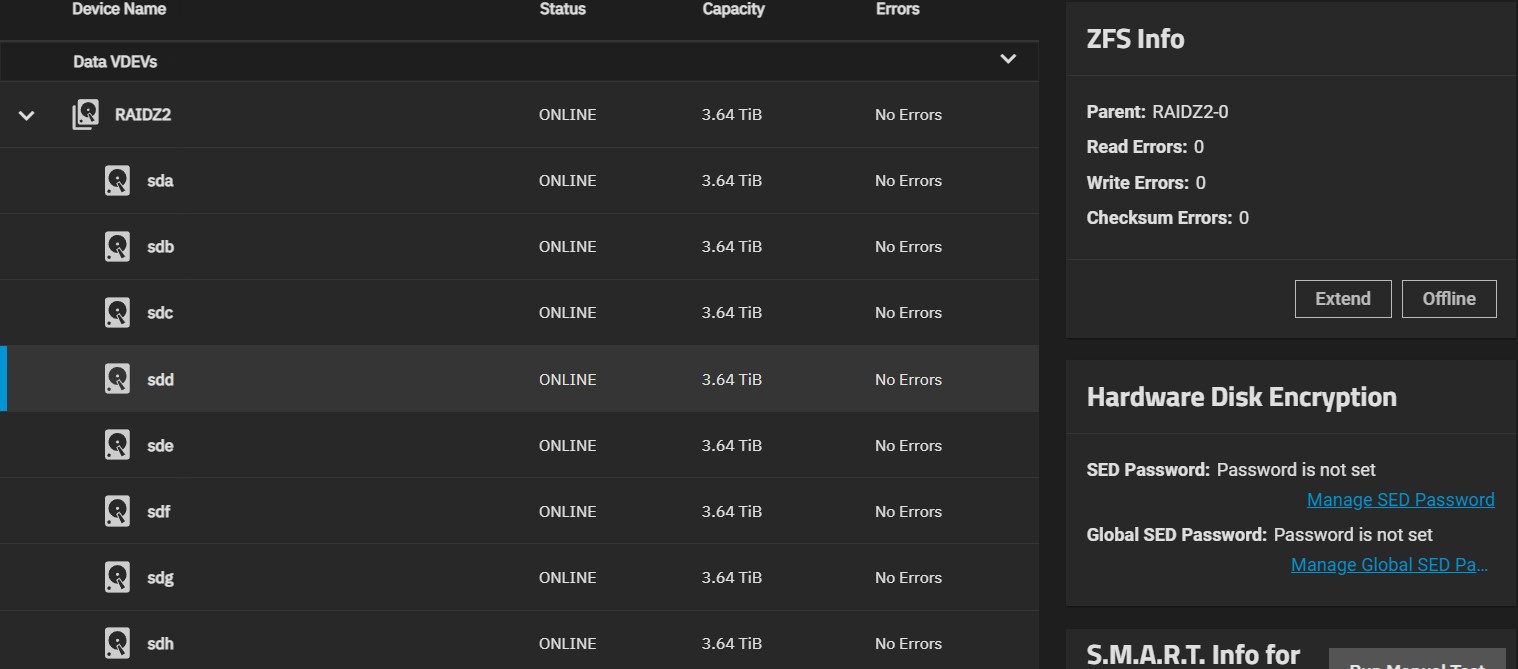

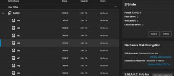

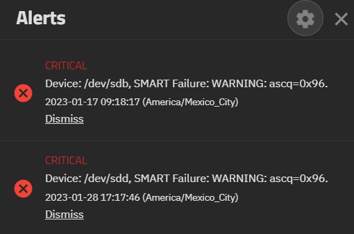

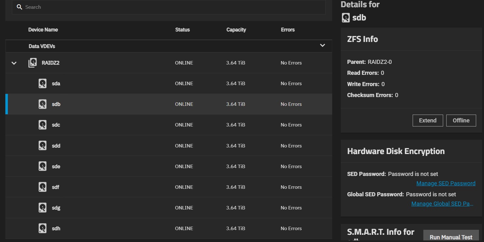

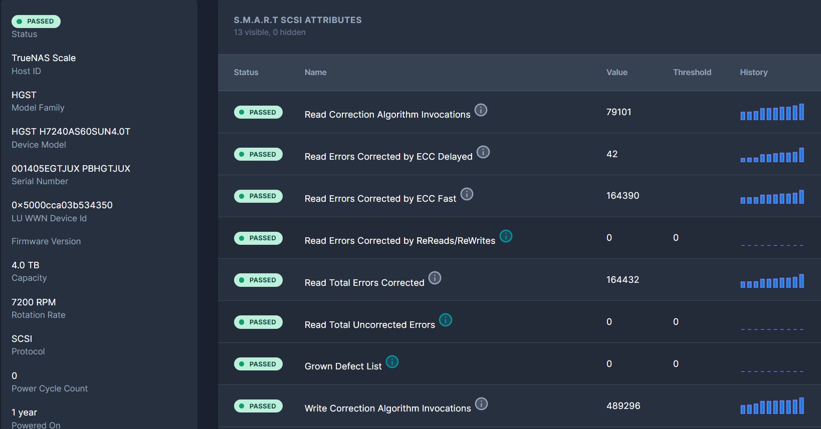

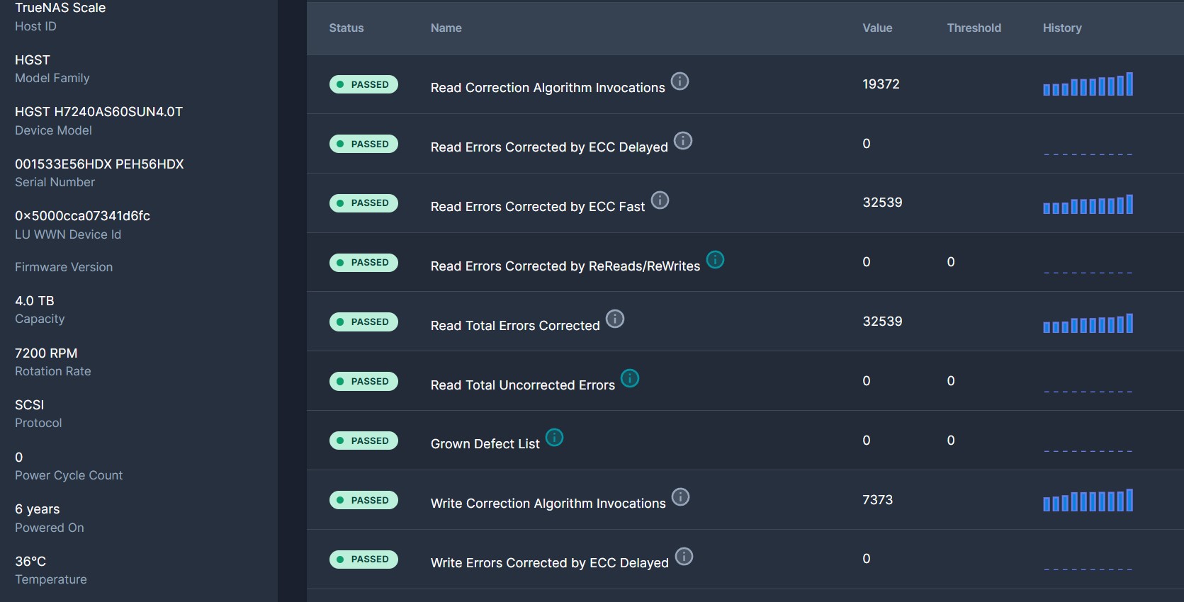

I am also having a SMART notification, but when performing LONG SMART test, they appear to have no errors, investigating with scrutiny, they appear to be ok
  • Device: /dev/sdd, SMART Failure: WARNING: ascq=0x96.
  • Device: /dev/sdb, SMART Failure: WARNING: ascq=0x96.

Performing the transfer from the other computer didn't work, I got the same error "Too many files are currently in use". I am now testing copying to another computer, and not to another share.
dgcdance
Jan 28, 2023
6
Update:
  • Pulling those files (+150,000) from TrueNAS share to another computer with a big HDD works
  • Copying from TrueNAS share to another share does not work, whether is done from a VM or another computer. Tried with windows copy, robocopy, teracopy, fails
  • Copying a large number of files from another computer to TrueNAS share fails.
Eventually, I lose access to that share from the computer or vm im trying to do the copying if I try accessing the share from another computer it works.

Update / Workaround
I've tried so much...
Using SSD pool only, n\ew VM's, settings like SMB instead of generic, sync off, a fresh install, and even increasing my ram from 32 Gb to 80 Gb
I am starting to think its something on the Windows side, I tried the following settings,
Disable the Windows Search Service’s Indexing
Turn Off the Remote Differential Compression
I've noticed an increase in performance, faster file discovery, and some transfers peaked 700 mbs, something that I haven't seen before, but eventually, the transfer fails, same error "Too many files are currently in use. Quit one or more programs, and then try again"
I prepared a VM with Ubuntu 22.04.1 LTS, mounted the shares and performed what I've been trying to do, and it worked, perfectly on the first try.
So WTF Windows! (This happened on Windows 10 Pro, 11 Pro, Server 2016, 2019, and 2022).
I was hoping to find the bottom of this problem and share a solution for anybody else having this issue, I will stop messing around in TrueNAS, and when I need to perform huge file copies, I'll just use my Ubuntu VM.
