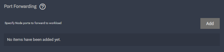

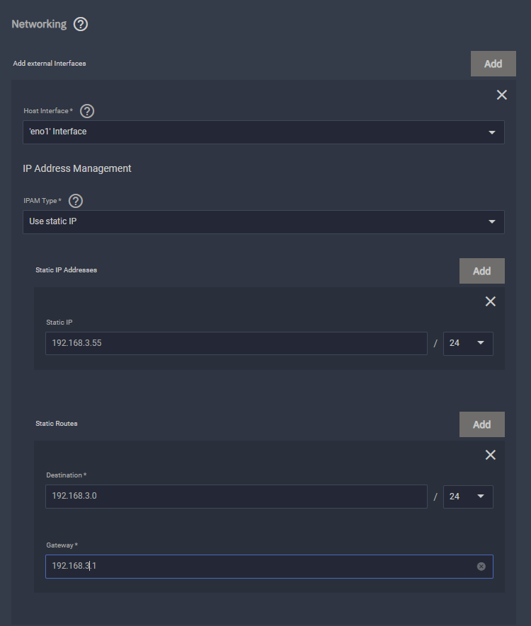

Thanks for the replies sretalla, I was able to get it working by setting a static IP for the docker container.
I went with the "Launch Docker Image", but i'm sure it would work for the TrueCharts implementation too.
Krowvin:
I even went as far as to try and set a static IP so I could use ports 80:80 and 443:443
The reason it did not work for static the first time I tried is because I was trying to set the ports.
I learned that if you use the "Launch docker image" if you leave all the ports blank they are open by default. Looks like this:

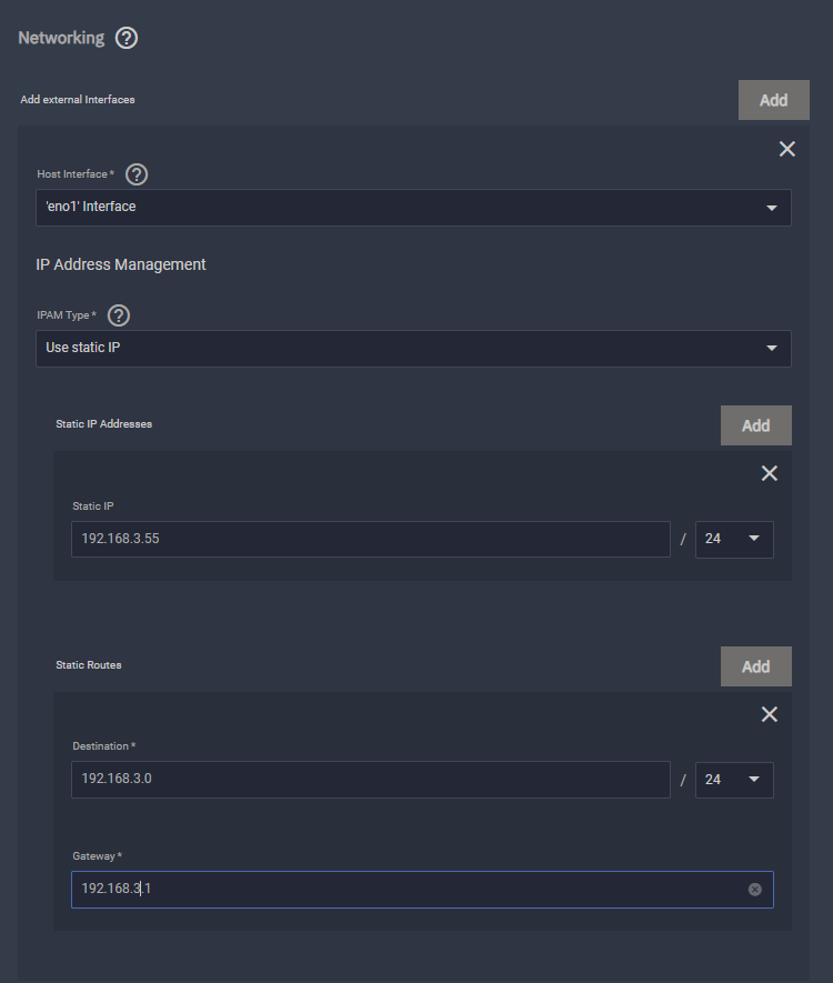

And here's the static IP setup for the container

I created account just to reply as I need some assistance as well. Are you able to provide some clarification or guide on how exactly you set this up through "Launch Docker Image". I see the IP details there, but it isn't super clear for me. Originally I was attempting to go through the truecharts method, but there is little to no documentation behind it.
I've attempted setting up a VM, but due to hardware issues I am unable to properly configure a bridge for it.
Apologies on inquiring as I am also quite new to truenas scale and would like some assistance if possible. :)
