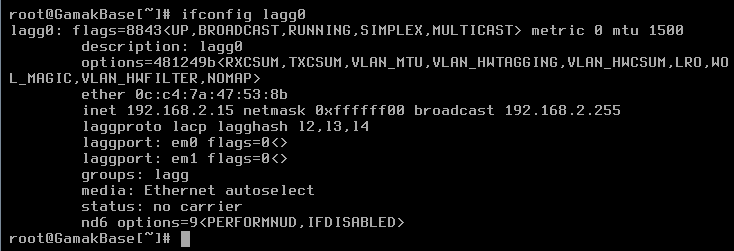

I have the latest TrueNAS Core with a mellanox 25g card with 2 ports. I have setup a lagg interface with LACP. The lagg0 interface shows no carrier, even though both NIC's show carrier. The switch is configured for lacp, and is working correctly with a linux based server already. What can I look at to trouble shoot this issue?

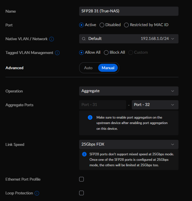

The switch is a ubiquiti USW-aggregation pro. I configured lagg with LACP through the local TrueNAS menu interface.
Here are a few screen shots:
Switch port config:

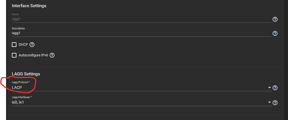

No carrier makes me think there is more to this than that. Even if the LAGG doesn't come up, you should have carrier. I personally loathe forcing speed and duplex. My personal experience is that forcing speed and duplex has caused way more problems than it ever solved, but your mileage may vary. Here is what the TrueNAS side looks like for one of my bare metal TrueNAS systems.
And here is what the Cisco switch side look like.

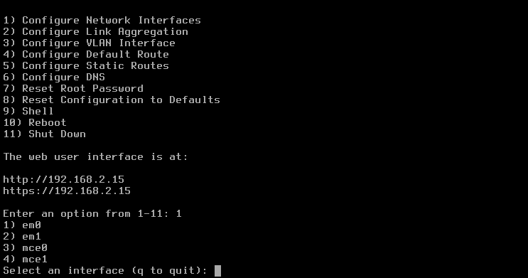

You configured your lagg0 with em0 and em1 as members instead of mce0 and mce1, probably.

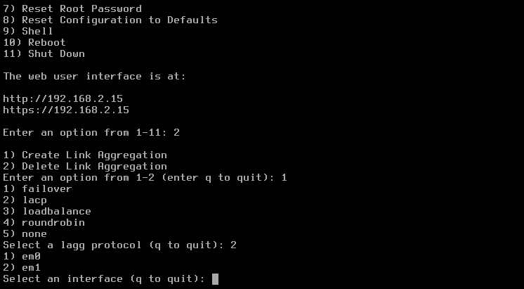

Very odd stuff happening. When trying to configure lagg I get the below.

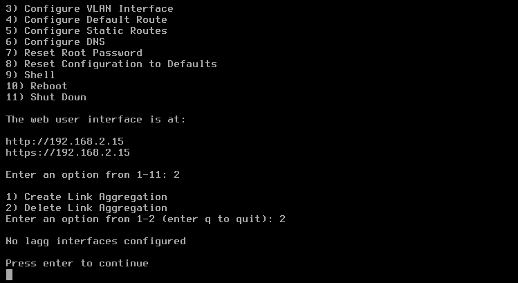

However if I then go to try to delete lagg, it says no lagg configured.

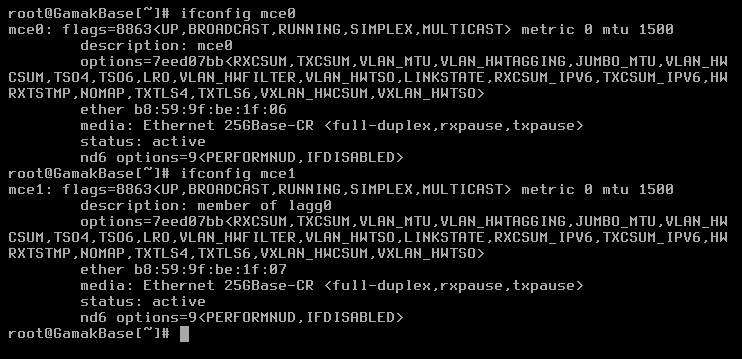

The network interfaces do show up as shown here.

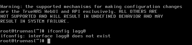

And according to the shell no lagg is configured.
Should I maybe try reseting the configuration to defaults?
Bane
Dec 31, 2017
43
I decided to go ahead and reset the configuration, and the issues seem to be gone. I reconfigured lagg and now it links up and all is well.
