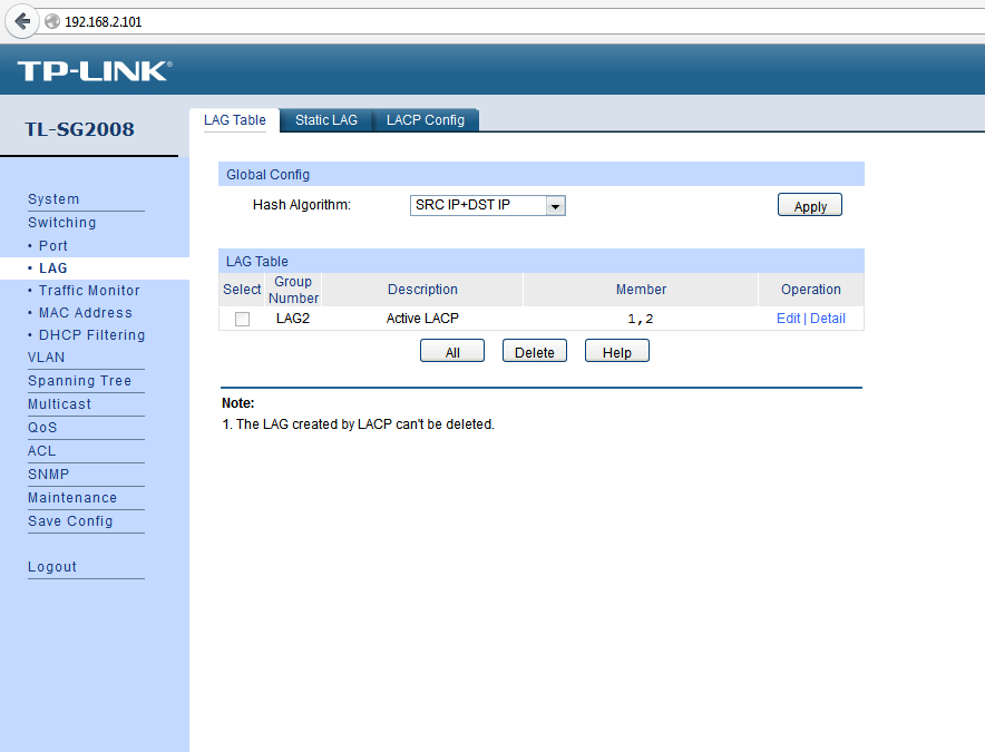

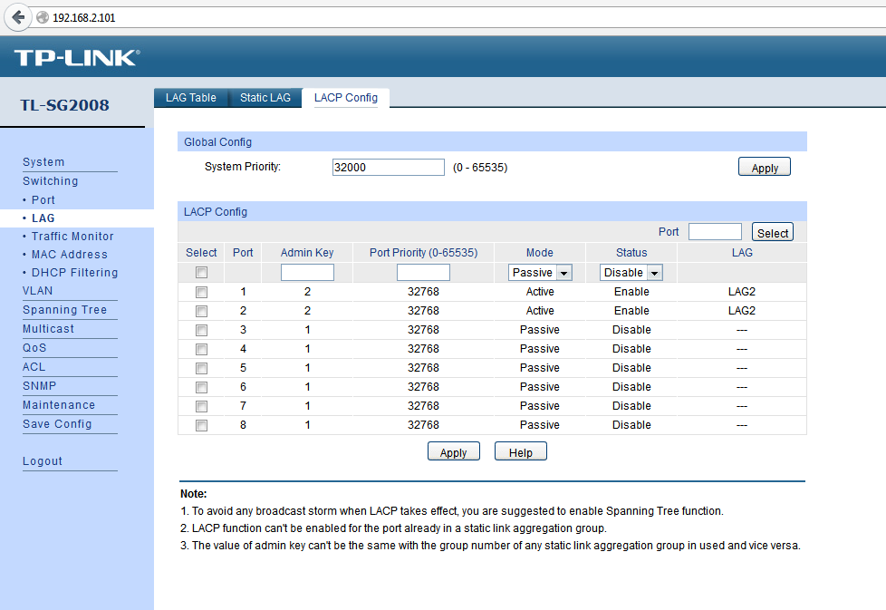

Now for the switch (config enclosed).. like I read on different websources the "mode" (screenshot lacp 2) is either active or passiv determined by if the device is managing the LACPDUs or only recieving?! But I don't know in which mode my freeNAS runs, either way I've tried both active and passiv without any luck.
Is there anything else I need to setup on either side?!

Is there any way to figure out if a component (freeNAS in this case) uses an active or passiv lacp mode?
