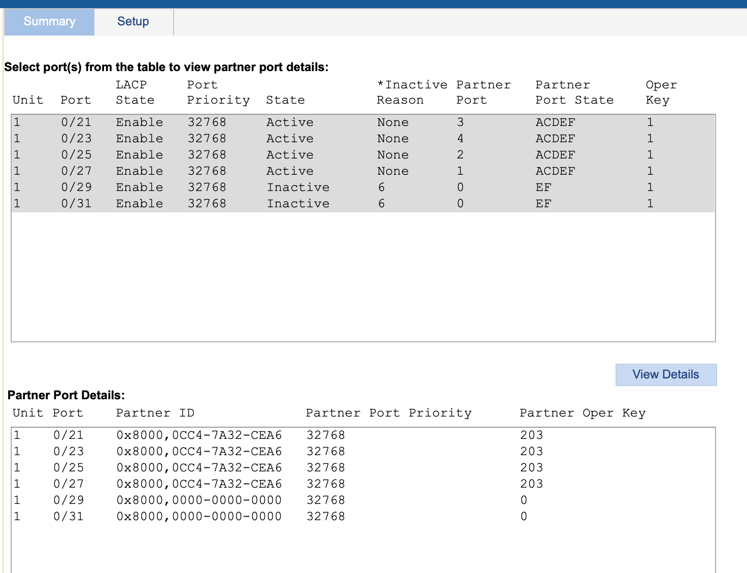

What does your switch side config look look?
Argh! True, I didn't show it. Sorry!!!
I confirm: it's LACP. I pulled my quad nic yesterday, but I didn't touch my switch conf. You will see two failing link, now instead of four.
Here is my HP v1920 switch conf. In brief: I configured a TRUNK pvid 1001, then the two VLANs for each downstream clients. VLAN10 is my production VLAN and FreeNAS admin interface is configured on that network.
VMs and Jails get their ip from VLAN10 and VLAN20 and its working without issue.
NO ip on LAGG, NO ip on VLAN20.

Bagg1:
[SW0]display interface Bridge-Aggregation brief
The brief information of interface(s) under bridge mode:
Link: ADM - administratively down; Stby - standby
Speed or Duplex: (a)/A - auto; H - half; F - full
Type: A - access; T - trunk; H - hybrid
Interface            Link Speed   Duplex Type PVID Description
BAGG1                UP   4G(a)   F(a)   T    1001
 Bridge-Aggregation1 current state: UP
 IP Packet Frame Type: PKTFMT_ETHNT_2, Hardware Address: d894-032b-9436
 Description: Bridge-Aggregation1 Interface
 4Gbps-speed mode, full-duplex mode
 Link speed type is autonegotiation, link duplex type is autonegotiation
 PVID: 1001
 Port link-type: trunk
  VLAN passing  : 10, 20
  VLAN permitted: 10, 20
  Trunk port encapsulation: IEEE 802.1q
 Last clearing of counters:  Never
 Last 300 seconds input:  0 packets/sec 61 bytes/sec    0%
 Last 300 seconds output:  0 packets/sec 231 bytes/sec    0%
 Input (total):  7470551 packets, 2000248620 bytes
     6472281 unicasts, 9079 broadcasts, 989191 multicasts
 Input (normal):  7470551 packets, 2000248620 bytes
 Input:  0 input errors, 0 runts, - giants, - throttles
     0 CRC, - frame, 0 overruns, 0 aborts
     - ignored, - parity errors
 Output (total): 16717215 packets, 6878087375 bytes
     8063589 unicasts, 5222777 broadcasts, 3430849 multicasts, 0 pauses
 Output (normal): 16717215 packets, 6878087375 bytes
 Output: 0 output errors, - underruns, - buffer failures
     0 aborts, 0 deferred, 0 collisions, - late collisions
     - lost carrier, - no carrier
Lagg members:
SW0]display link-aggregation verbose
Loadsharing Type: Shar -- Loadsharing, NonS -- Non-Loadsharing
Port Status: S -- Selected, U -- Unselected
Flags:  A -- LACP_Activity, B -- LACP_Timeout, C -- Aggregation,
        D -- Synchronization, E -- Collecting, F -- Distributing,
        G -- Defaulted, H -- Expired
Aggregation Interface: Bridge-Aggregation1
Aggregation Mode: Dynamic
System ID: 0x0, d894-032b-9420
Local:
  Port             Status  Priority Oper-Key  Flag
  GE1/0/21         S       32768    1         {ACDEF}
  GE1/0/23         S       32768    1         {ACDEF}
  GE1/0/25         S       32768    1         {ACDEF}
  GE1/0/27         S       32768    1         {ACDEF}
  GE1/0/29         U       32768    1         {ACG}
  GE1/0/31         U       32768    1         {ACG}
Remote:
  Actor            Partner Priority Oper-Key  SystemID               Flag
  GE1/0/21         3       32768    203       0x8000, 0cc4-7a32-cea6 {ACDEF}
  GE1/0/23         4       32768    203       0x8000, 0cc4-7a32-cea6 {ACDEF}
  GE1/0/25         2       32768    203       0x8000, 0cc4-7a32-cea6 {ACDEF}
  GE1/0/27         1       32768    203       0x8000, 0cc4-7a32-cea6 {ACDEF}
  GE1/0/29         0       32768    0         0x8000, 0000-0000-0000 {EF}
  GE1/0/31         0       32768    0         0x8000, 0000-0000-0000 {EF}
[SW0]display link-aggregation member-port
GigabitEthernet1/0/21:
Local:
    Port Number: 21
    Port Priority: 32768
    Oper-Key: 1
    Flag: {ACDEF}
Remote:
    System ID: 0x8000, 0cc4-7a32-cea6
    Port Number: 3
    Oper-Key: 203
    Flag: {ACDEF}
Received LACP Packets: 165432 packet(s)
Illegal: 0 packet(s)
Sent LACP Packets: 168908 packet(s)
GigabitEthernet1/0/23:
Local:
    Port Number: 23
    Oper-Key: 1
    Flag: {ACDEF}
Remote:
    Port Number: 4
    Oper-Key: 203
    Flag: {ACDEF}
Received LACP Packets: 165414 packet(s)
Sent LACP Packets: 168851 packet(s)
GigabitEthernet1/0/25:
Local:
    Port Number: 25
    Oper-Key: 1
    Flag: {ACDEF}
Remote:
    Port Number: 2
    Oper-Key: 203
    Flag: {ACDEF}
Received LACP Packets: 165398 packet(s)
Illegal: 6 packet(s)
Sent LACP Packets: 174442 packet(s)
GigabitEthernet1/0/27:
Local:
    Port Number: 27
    Oper-Key: 1
    Flag: {ACDEF}
Remote:
    Port Number: 1
    Oper-Key: 203

Ah, wait Elliot. I reconfigured this morning (CEST time!) that switch to test LACP in hybrid mode, and it's working "exactly" as in trunk mode, my default configuration. Please, take "exactly" as is. I only know that access will never work here.
At the very least, 0 seems like a bad option
And this sounds strange, I didn't pay attention to that!
On web console Port Priority is set (automatically) to the correct value:
But it should not a problem: console access on that switch is a hack, I usually manage via web interface and use console just to get information/debug instead of screenshots.
Tomorrow I'll try to test the quad, in trunk and hybrid mode and will report.
Thanks for your time!
