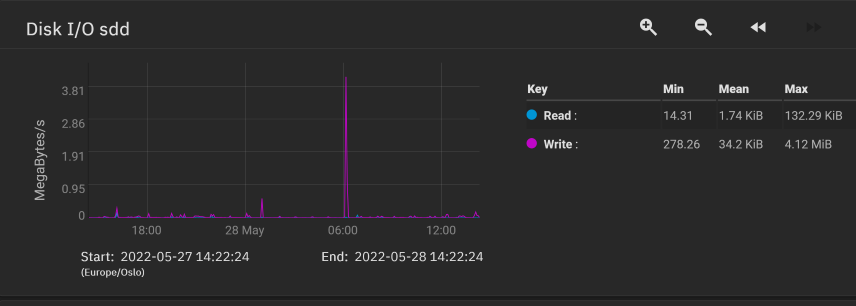

My situation is a multi-purpose home server, with a varied workload (maybe more varied than many home users). The usage is very bursty and at the time (after a few days of uptime), basically everything has gone in the ARC, so I don't have anything to report on the L2ARC. I can say that it doesn't thrash the disks constantly with writes, though, so that's a good sign. Here's one out of three L2ARC disks - not much writing:
