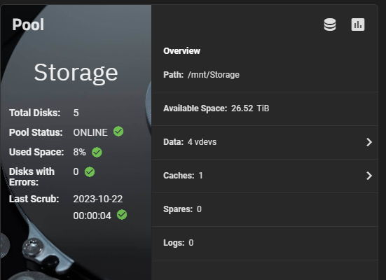

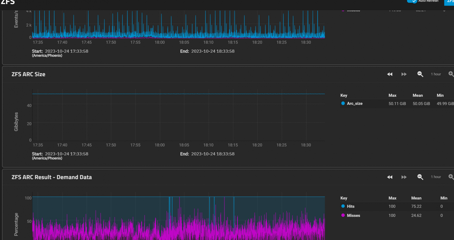

Upgraded to 23.10RC and to 23.10.0 stable. My l2ARC is not showing in ZFS reporting. It does show up in Netstat.

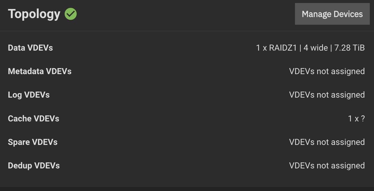

Does your cache vdev disk size show up in the storage Topology?
I seems to be facing a weird issue where after rebooting the cache vdev would show up as "1 x ?"
Had to remove and readd to the pool as a cache vdev for it show the disk size.

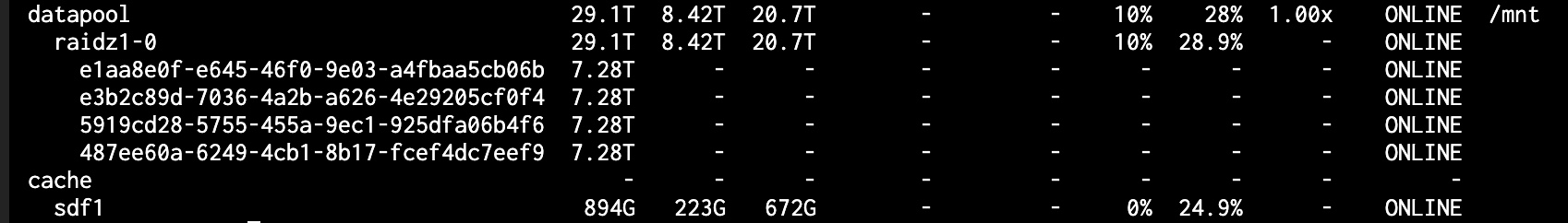

Yes it does show in Disks and Storage

Not sure if this a bug, but my cache drive on the UI is showing as 1x? while in cli i do see the drive.
As for the L2Arc, i facing the same issue as the thread starter.

Same problem here. After every reboot, the cache drive shows up as 1x?. Even after removing and adding the cache drive again to remove the 1x? problem, no statistics for L2ARC under statistics reporting.

It's not showing under Reporting/ZFS for 23.10.1.3 either. However, if you install the app Netdata. You'll get the L2ARC reports you (probably) are looking for.
