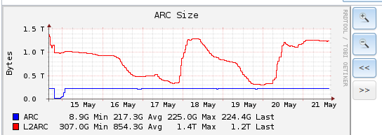

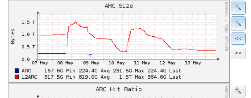

I have a 1.2tb L2 Arc and it's doing something weird. it's stuck at 400gb right now.
It used to sit around 1Tb.... I'm running FreeNAS-9.10-STABLE-201605021851 (35c85f7)
Any ideas?

I just looked at what kspare posted and that the normal behavior of his system has changed for the worse. Hence the bug report suggestion, if it's not a bug no harm no foul, but why not check it out.

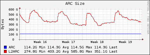

Sakuru
Nov 20, 2015
527
The L2ARC on my WorkTEST box waffles too. I just assume it's garbage collection or something. It's running 9.10-STABLE-201604111739

L2ARC stuff *can* be evicted if ZFS decides its of no value. Then, if there is no data worth adding to the L2ARC, the size will shrink.
This sounds totally normal and is nothing more than fluctuations in the usage of the system. Of course, a chart isn't really good enough evidence to argue that a bug doesn't exist, but it doesn't confirm all is "okay" either.

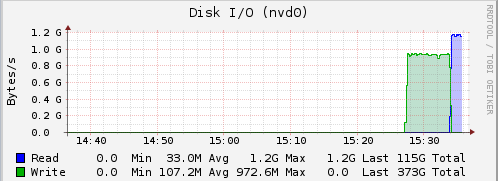

Hey guys, sorry I forgot I posted this.
I did a mass move on the box and it topped out. I think its just what cyperjck said above. We aren't pushing the box hard enough to make it go larger.
I just moved a large amount of data on that box as I burn in some drives on my other san.....got a bad 4TB RE drive. so decided to do a burn in on the whole pool.
For laughs I did it on a 400gb Intel 750...it's got decent speed lol.
Anyway my l2arc goes up depending on what im doing.
