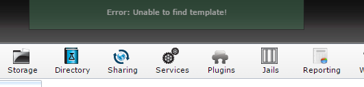

I've recently built my own freenas box and have been tinkering with the filesharing for my family and what not. However I'm stuck at trying to get any plugin installed at all.
All that happens is the download starts and everything seems to be working correctly. It starts "creating" the template and actually reaches 100% freenas1.png . However, after this step the process stops and this error message appears for every plugin that i've tried. Screenshot_1.png

Was this a fresh install of 9.10 or did you upgrade from 9.3 (or use a config from a 9.3 system)?

Hello dlavinge, thanks for your reply!
This was a fresh install of 9.10. I also noticed the repository URL for the jails seemed to be wrong. But changing it did not help.

Seems that making a separate dataset and then setting the jail path to this caused the issue. Fresh install works if I don't change the jail mount. Fresh install -> set ip settings right -> install plex works. It'll then create the mount point itself. This dataset called jails can not be reduced in size it seems(wanted to make it 100gib but i'll give an error if I try to do so.).
Interesting, I had a similar issue after moving my jails dataset to a different pool, which went away after I moved it back.
When I fresh install and let FreeNAS create it's own 'jails' dataset I can get it to work. Removing all datasets and making a fresh dataset for jails doesn't work either.
