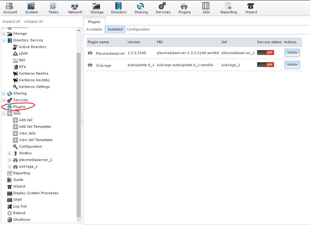

For what it is worth, I am getting the same error. I tried installing SickRage to see if that would work; it did not.
Jan  7 23:30:13 freenas manage.py: [freeadmin.navtree:577] Couldn't retrieve http://10.0.10.x/plugins/plexmediaserver/1/_s/treemenu: timed out
Jan  7 23:30:13 freenas manage.py: [freeadmin.navtree:577] Couldn't retrieve http://10.0.10.x/plugins/sickrage/2/_s/treemenu: timed out
Jan  7 23:31:32 freenas manage.py: [plugins.utils:91] Couldn't retrieve http://10.0.10.x/plugins/sickrage/2/_s/status: HTTP Error 503: OK
Jan  7 23:31:32 freenas manage.py: [plugins.utils:91] Couldn't retrieve http://10.0.10.x/plugins/plexmediaserver/1/_s/status: HTTP Error 503: OK
One other curious thing is that there are no plugins listed on the left column menu (see screengrab). Shouldn't there be?
But according to the screenshot, it actually installed just fine. That error message has actually been happening for years.
Yes the plugins should show up on the left hand side, but I have seen it not work sometimes. Try opening the GUI with another browser and see if it's still missing
I tried IE and it gave me a nonfunctioning menu down the center of the page. MS Edge gave me the same thing that Chrome did (I used Chrome for the screengrab on my last post). I also cannot ping from the Plex jail.

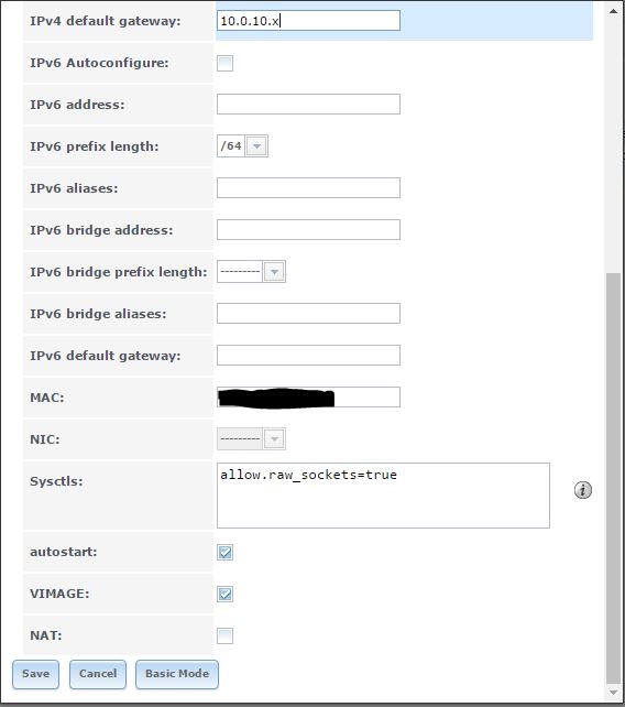

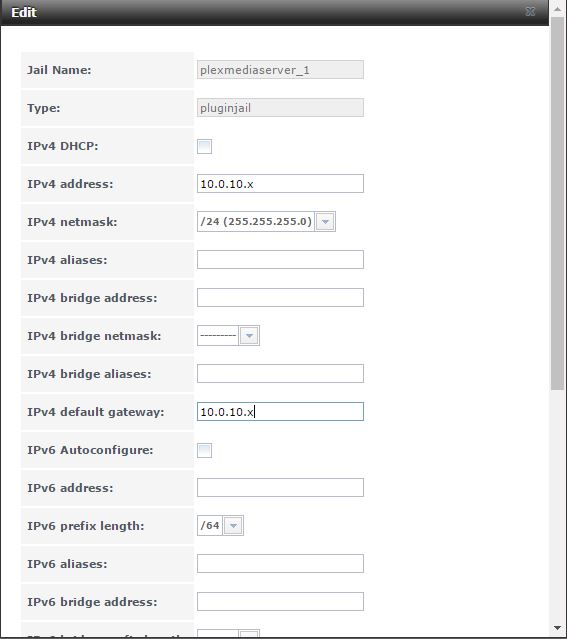

See the attached first two files for how I have it set up in the GUI.
root@plexmediaserver_1:/ # ifconfig
		options=600003<RXCSUM,TXCSUM,RXCSUM_IPV6,TXCSUM_IPV6>
		inet6 ::1 prefixlen 128
		inet6 fe80::1%lo0 prefixlen 64 scopeid 0x1
		nd6 options=21<PERFORMNUD,AUTO_LINKLOCAL>
epair0b: flags=8843<UP,BROADCAST,RUNNING,SIMPLEX,MULTICAST> metric 0 mtu 1500
		options=8<VLAN_MTU>
		ether 0x:fx:7x:0x:0x:0x
		inet 10.0.100.155 netmask 0xffffff00 broadcast 10.0.100.255
		inet6 2601:401:xxx:xxxx:: prefixlen 64 tentative
		media: Ethernet 10Gbase-T (10Gbase-T <full-duplex>)
		status: active
Are you suggesting I set IP, gateway, and NS from the shell?
		options=8<VLAN_MTU>
		status: active
I am confused. your screenshot shows an invalid IP address. 10.0.10.x ? X is not a value that can be used in an IP. According to your ifconfig, your IP is 10.0.100.155.
Don't make these changes from the CLI/shell, fix them in the GUI.
Silent J
Mar 25, 2016
9
Sorry, the x's were my attempt to block out the IP (which probably doesn't matter because its internal). Sorry for the confusion. My IP in the GUI is set to 10.0.10.160. I do not know where the 10.0.100.155 came from - that is not even a valid subnet in my network (but that is what the response from ifconfig).
