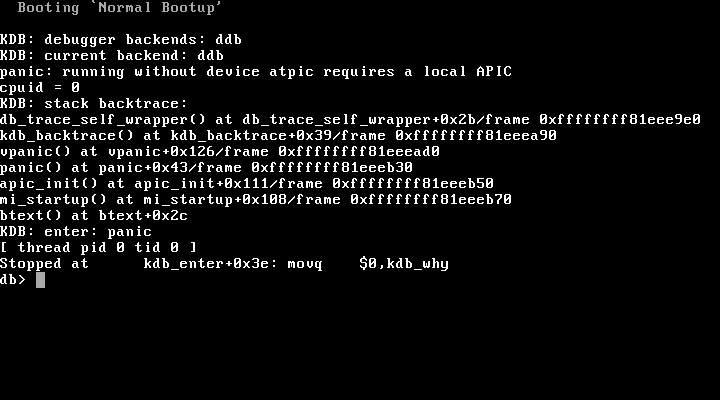

Hello all,
I tried to reboot my freenas server today. When booting up it gets to the point of zfs pool import and then I get a kernel panic.
I'm running the latest 9.10.2-(u6). Machine has been running flawlessly for years.
I'm at a loss as to what to do next. I am currently running memtest86 just in case there's memory issue.
Any ideas?
dvand
Oct 5, 2014
35
I'm not sure what is going on. After trying many dozens of times it went past the pool import and then the machine powered itself off.
I tried booting again and I got another kernel panic. Image attached.

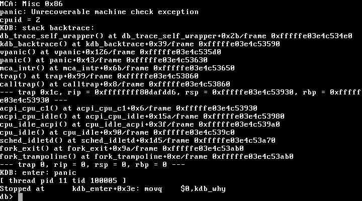

dvand
Oct 5, 2014
35
disconnected the drives and attempted to boot.
Get a different crash.
