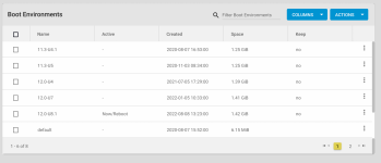

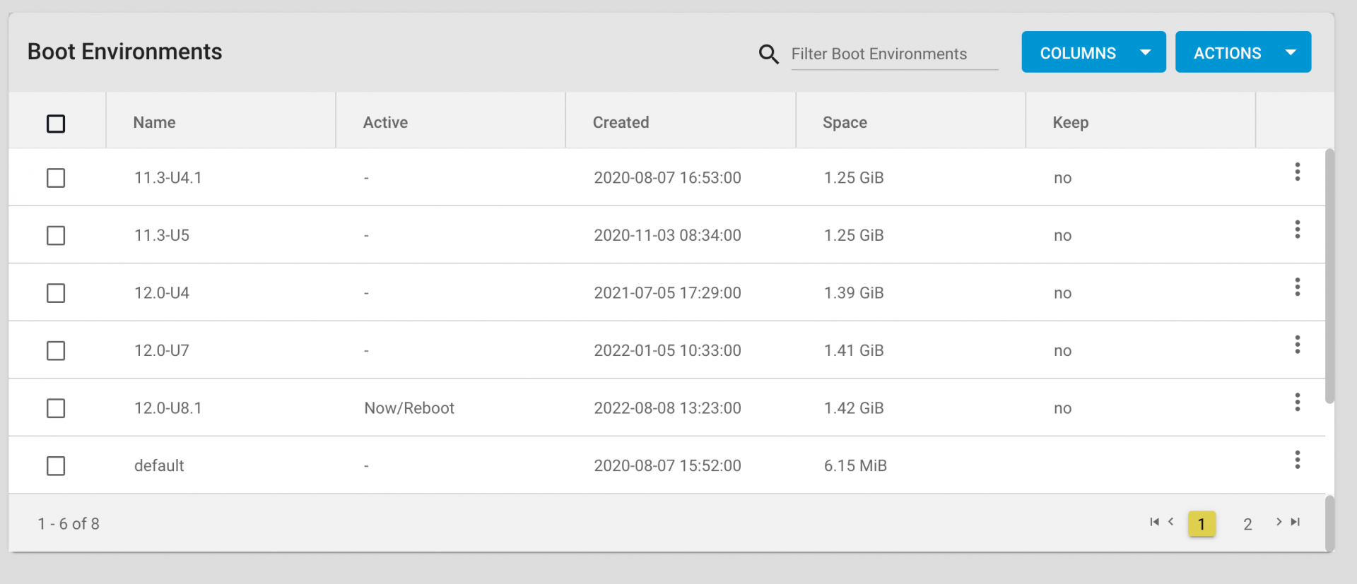

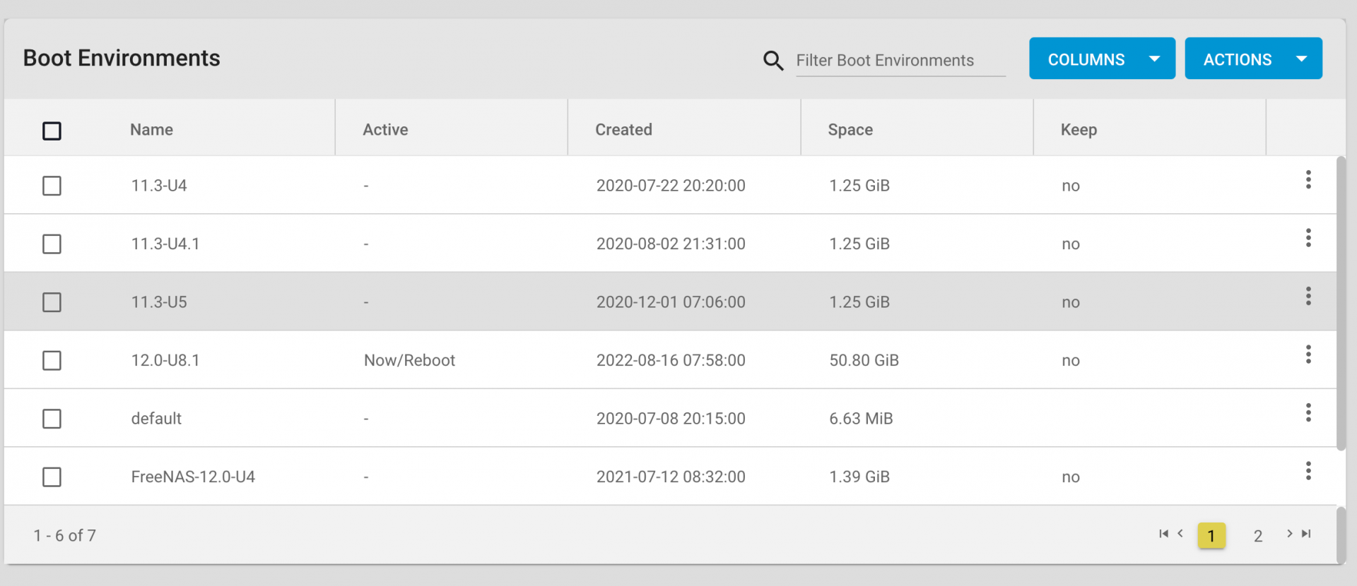

@Fab Sidoli Can you post a screenshot of the System > Boot menu? You should be able to activate the older boot environment there and then reboot into it.
Fab Sidoli
May 15, 2019
114
Please see the attached. The failover server has the older 12.0 boot environments. The prod does not, even though it was previously running 12.0-U4. I also not the boot image on the prod for 12.0-U8.1 is over 50GB in size.

Patrick M. Hausen
Nov 25, 2013
7,776
There is a 12.0-U4 at the bottom of the prod screenshot. Also beadm list is way more convenient than the zfs | grep you used :wink:

I wasn't sure this was the correct thing because the failover has an actual 12.0-U4 listing (as well as a FreeNAS-12.0-U3), so I was expecting to see the same. I'm not sure if the naming convention is significant.
I'm also not sure why the 12.0-U8.1 is near 60GB in size vs the other images on both systems.
