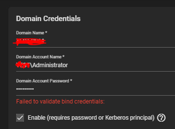

Hi everyone,
Im kinda new to TrueNAS and I'm working on a small proof of concept for school.
I'm stuck with one problem: When I'm trying to join my domain it gives this error:
I can ping the domain and the domain controller.
Anyone knows a fix?

What's the full version? 12.0 doesn't tell us that much.

For the domain account name, try just the account without the domain in front. It's probably prepending the domain in front of your domain\account, so of course there won't be an account matching domain\domain\account.

I tried that already, didn't work

update to U7, there is a critical winbindd security vulnerability in U5, otherwise Samuel Tai is right. Later versions also have better error reporting.
Did this, same error. Should be something with the domain account then right?

Are you leaving the \ in front of the account?

How is your domain set up? This smells like password authentication for Administrator has been disabled.
Also, have you looked at the manual? https://www.truenas.com/docs/core/directoryservices/activedirectory/
You've already stated DNS is working. How about NTP? Are you sync'ed to the DC? Are you using the NetBIOS domain or the DNS domain for your forest?

Yes, NTP is enabled. I think I'm using the DNS domain.
How do I check password authentication option?

The particular place you're failing at is when we try to kinit to get a kerberos ticket. You can try to kinit from CLI by running command `kinit administrator@fqdn`. It might give more useful information.

I haven't set up Kerberos or anything tho, should I do that? Kinda new to this stuff.

AD requires Kerberos. No wonder it's not working. You're just trying to join an ordinary domain.

In theory if you have properly-functioning DNS, the OS kerberos client should allow you to kinit if you specify the FQDN. This probably indicates a DNS issue. Perhaps relevant SRV records for kerberos are not able to be queried through the configured nameservers.
