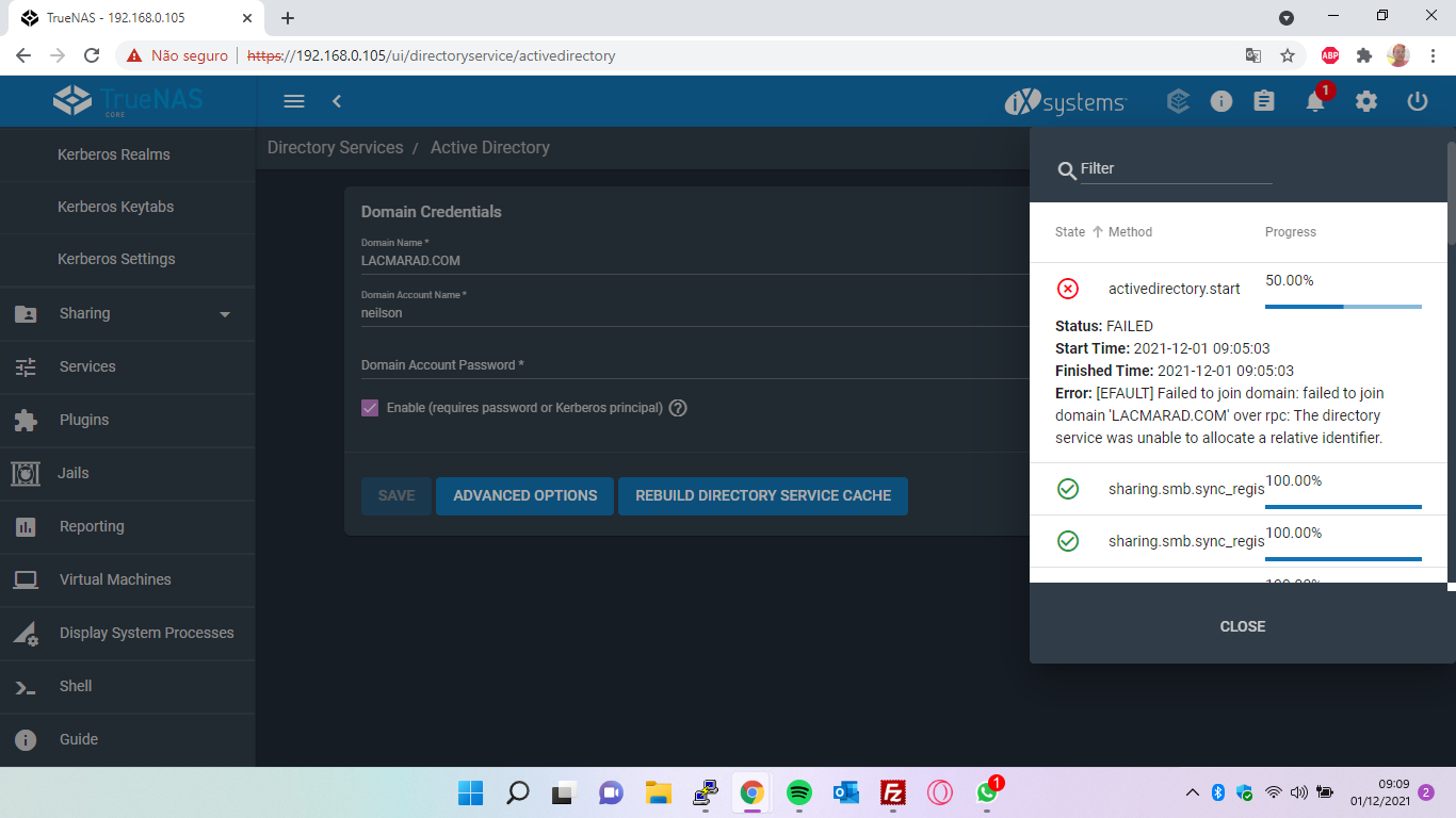

I'm having problems, my active directory server gave an error and when returning the truenas showed an error in the service and I can't join it anymore, can someone help?

windowns server 2012 , I had an error after a problem in the s.o and I took a snapshot to blame the forest

Without looking closely at the issue, it appears that the DC we're talking to is unable to allocate a RID. May be an issue with the server with RID master FSMO role. Hard to say, but you should probably look carefully at active directory logs.
