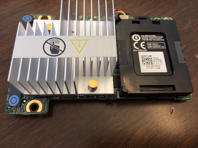

Hard to tell what the original controller is. Is a completely stock server, a Perc H310? I am running 8 15k sas drives.

I uploaded a picture of the controller, it probably isnt a PERC 310, judging by pictures of a 310 on the internet.
